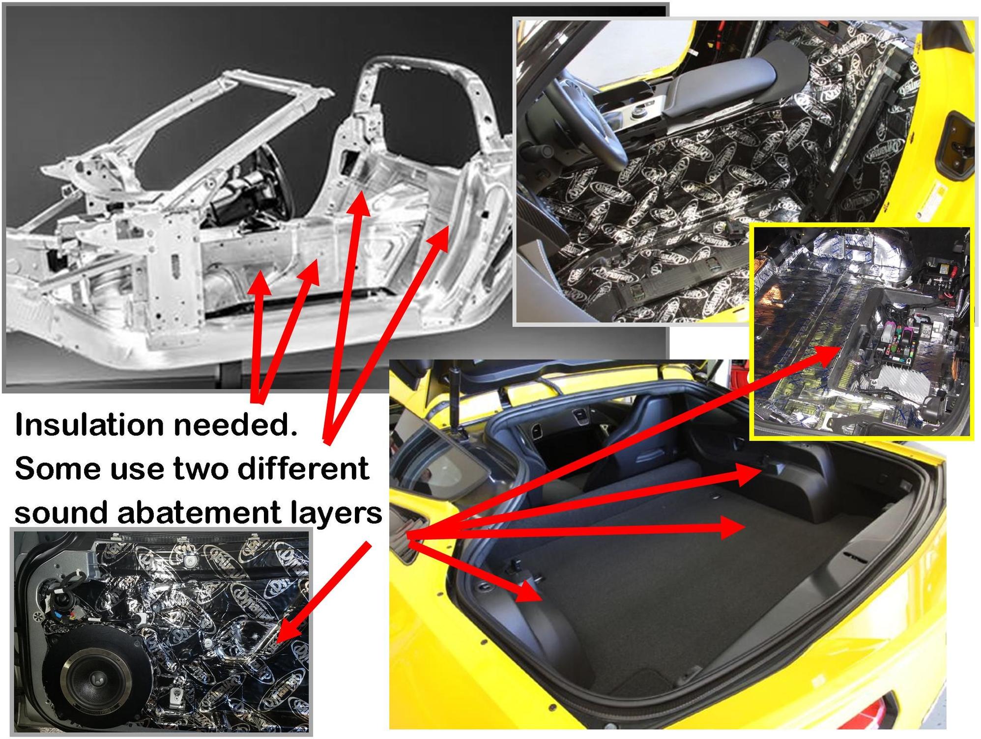

I did my doors and everything behind the seats, rear bulkhead and all of the cargo space and both sides up to the side windows with two boxes of Dynamat. I was not only trying to cut down noise but also the heat transfer from under the cargo area. It did drop the db's down about 6 to 8 decibels (also installed the heavy Lloyd's Carpet front and rear) and slowed down the heat transfer on long road trips. It's a lot of work, especially doing the doors (inside and out); you'll have to pull everything out of the car, seats, console and all the carpet....somewhere on this forum I have a thread with pics doing the rear cargo area and bulkhead. As I recall, it was an all day job doing the rear and another day doing the doors.
Bottom line, it was worth it to me, very noticeable when jumping from once C7 to another. Now if you want to improve the ride along with cutting the noise level, lets talk Non-Run Flats.

From many posts on reducing noise, if you're going to do it, go all the way!
The aluminum panels, wheel wells, doors all have to get noise insulation materials. The aluminum panels behind the seats an torque tube are key NOT just the rear flat area!

Yup, did just that plus pulled the door speakers and put a layer on the inside or the outer door skin. Also put a layer on the inside and top of the lid the covers the electronics in the cargo area. The only area I haven't done is under the front seats cause I ran out of material and ambition.....
