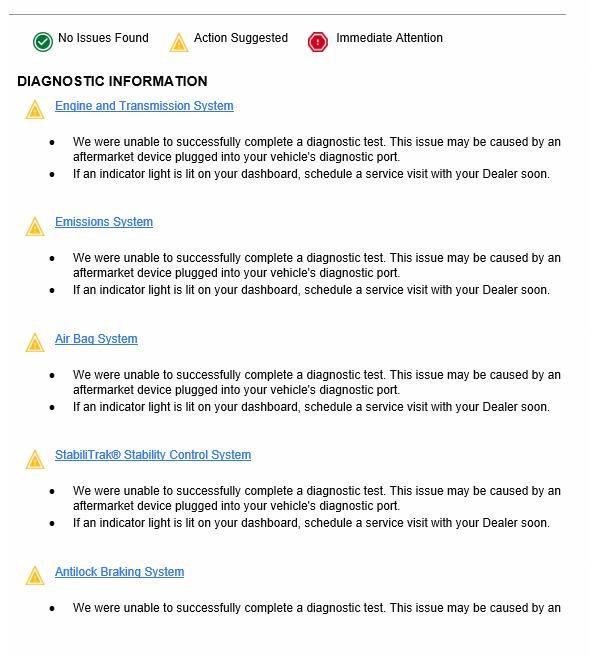

The new Range plugs will not draw on the battery with the engine off. When all the LEDs are dark, there is no draw.

Originally Posted by eboggs_jkvl
Having the range plugged in will negate OnStar from doing a complete monthly check on your car. It will result in a partial report.
Elmer
That's interesting as I've got the Range plugged in and get my diagnostic reports all the time...
No Issues Found
Action Suggested
Immediate Attention
DIAGNOSTIC INFORMATION

Old Aug 7, 2019 | 10:48 AM
TXSteveF's Avatar
TXSteveF
Joined: Feb 2018
Posts: 348
Likes: 175
From: Central Texas
I agree. I've had mine plugged in for almost two years and always get a complete report. I've never received an incomplete report.
Old Aug 7, 2019 | 10:58 AM
bjones7131's Avatar
bjones7131
Joined: Jan 2014
Posts: 4,496
Likes: 856
From: Walhalla South Carolina
Default Range
Never affected my report at all
