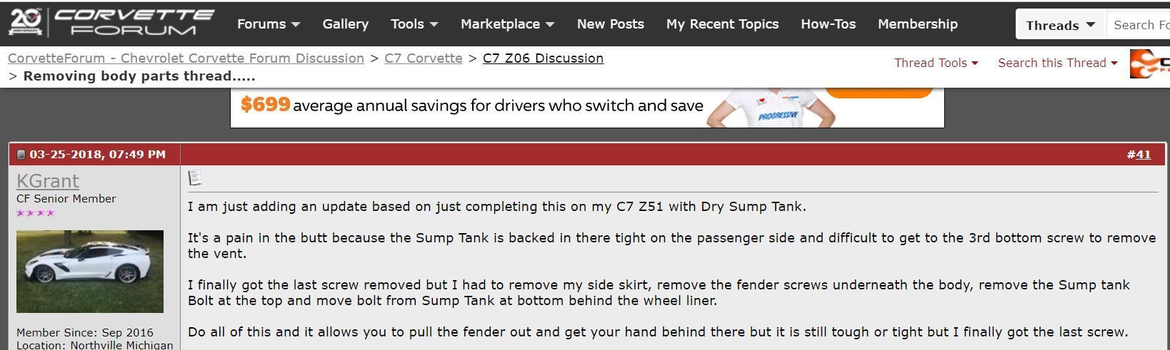

I agree with this assessment but the passenger side is much harder and I needed to remove the side skirt and some of the bolts holding the fender on to pull the fender out some to get more room. See my post #41 as part of this thread -----> https://www.corvetteforum.com/forums...-thread-3.html
I am just adding an update based on just completing this on my C7 Z51 with Dry Sump Tank. It's a pain in the butt because the Sump Tank is backed in there tight on the passenger side and difficult to get to the 3rd bottom screw to remove the vent.
