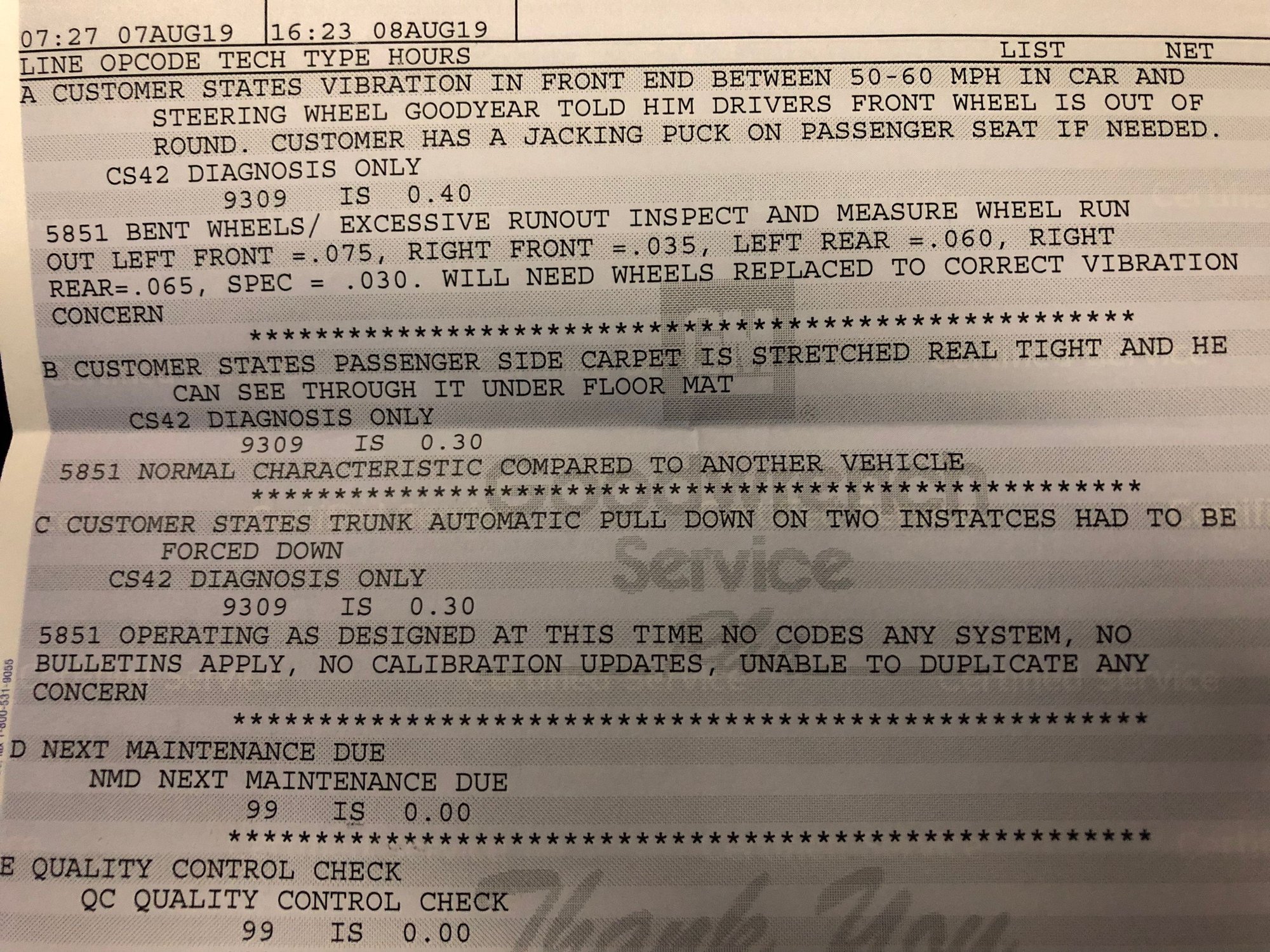

Never thought that I would have an issue, but all 4 of my wheels are out of round. I never hit anything that would cause me to raise an eyebrow. I felt a slight vibration in the steering wheel and heard the front tire whirring. I thought a wheel was out of balance. I took the front wheels to Goodyear to have them checked. They told me my wheel was bent. I took my car to the dealer and they checked all 4 and found them all out of spec for runout. I was shocked. Less than 6K miles on my 17 GS and I am the original owner.
GM Warranty Manual should state they guarantee customer dissatisfaction not satisfaction. When you call customer service, they use some dimwit that knows nothing about cars and won’t let you talk to someone who does. Then when your warranty is denied, they use a lame excuse that the wheel damage is due to “road conditions” then just tell you to they are sorry and basically F off after that. They don’t define “road conditions” or explain how all odds are overcome when 4 of your wheels are out of spec. Then, if you want to buy their weak wheels they can’t even supply them to you or tell you when they will be available even though they want to rip you off for $3,900 for a set of 4.
I believe most victims don’t even know their wheels are bent because anything greater then 30 thousands runout is out of spec. If they are cracked, then your indicator will be loss of air.
Here’s some reading for the uninformed that that shows how much GM cares about it’s customers and my dealer service order below. If you want a wide body C7, you better negotiate another $3K or so off your bottom line price to put toward a set of non-GM wheels.

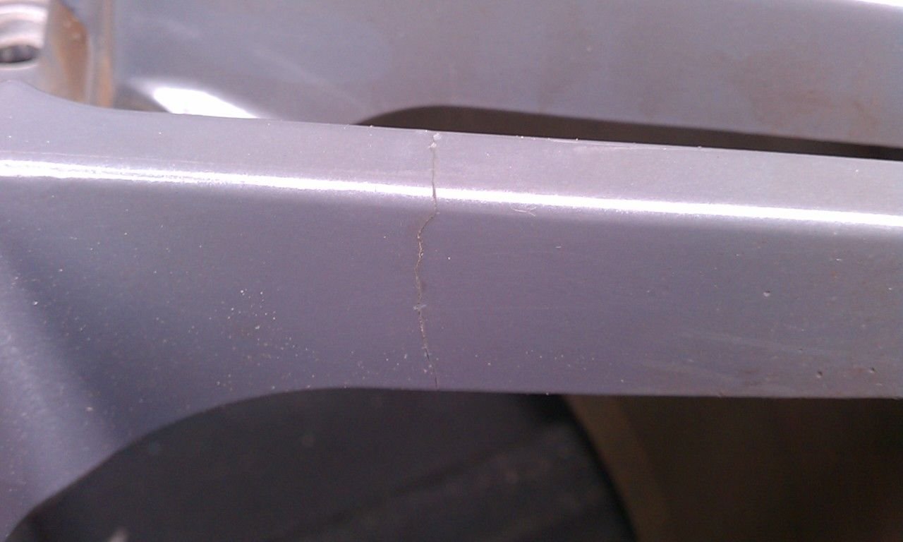

Here's my OEM C6 Z06 cracked wheel. GM did squat to replace them.
