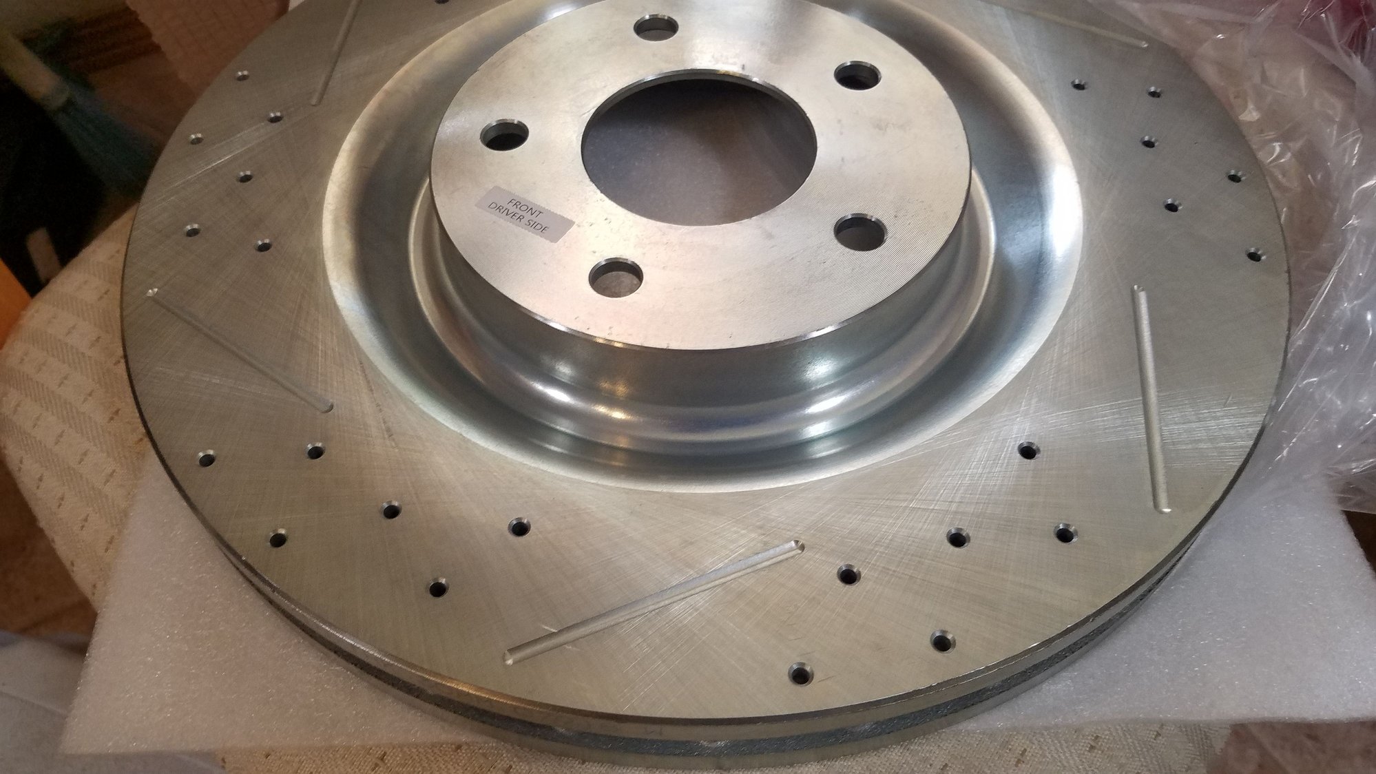

Powder Coated Calipers with Z26 PowerStop
Zinc Played Rotors
