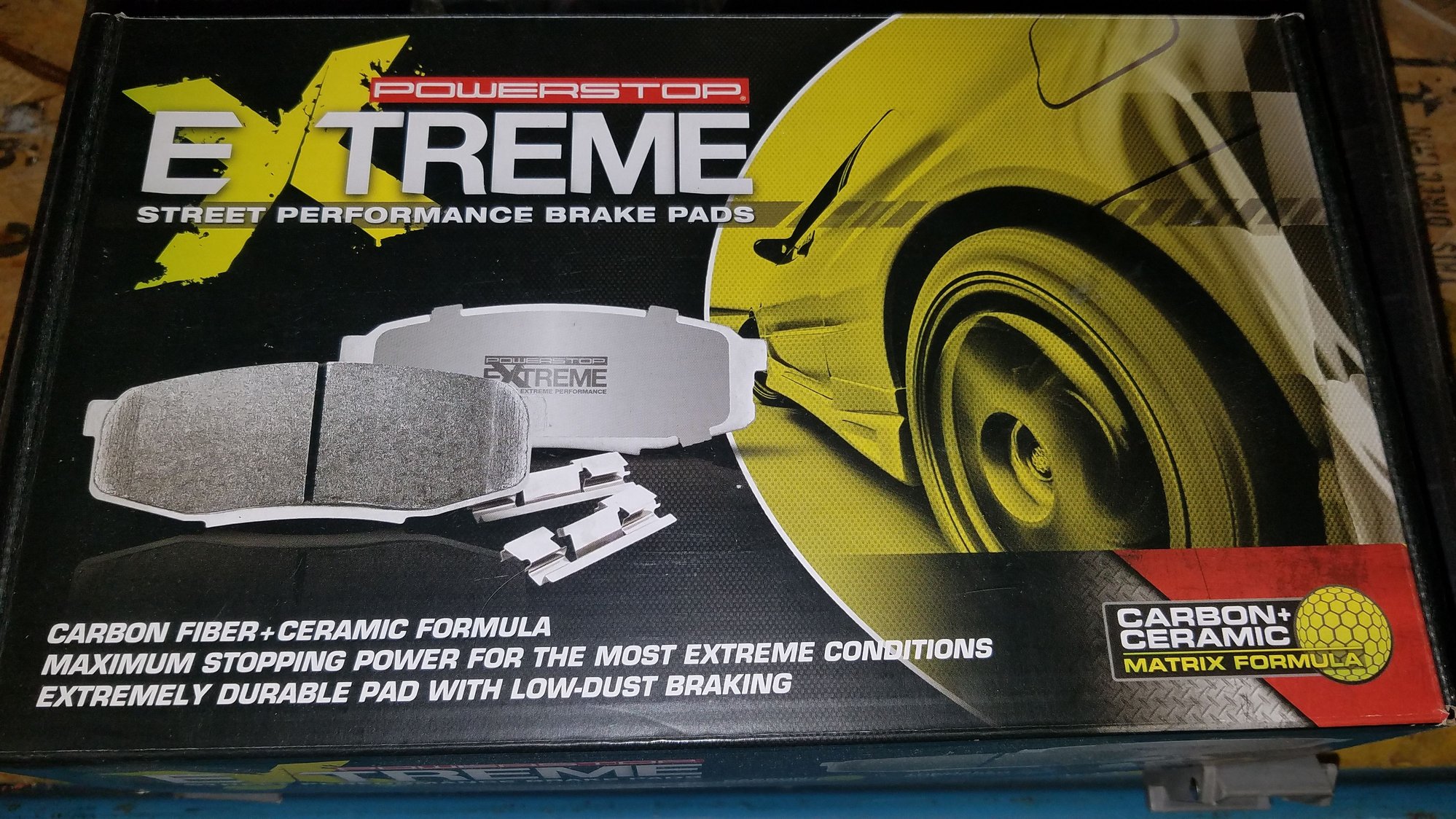

I ordered my POWERSTOP at RockAuto
and My Zinc Plated Rotors on EBAY
