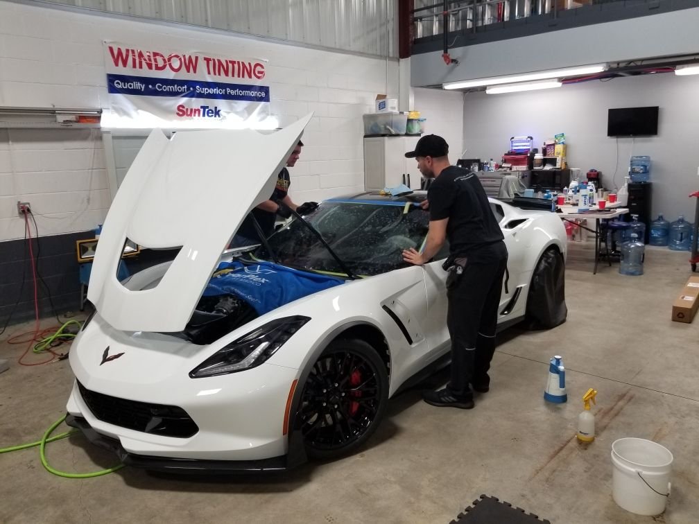

Have you looked into a product like clearplex?
I had that installed on my 19 when picked up (2 weeks after it was built). Like a sacrificial skin that can be peeled and replaced for about 400.
I amazed how clear it is. Youd never know it was there. And it blocks 99% of the UV rays into car.
had it done with my clear bra and 60% ceramic tint (Suntek) install.
Much less intrusive than having the windshield torn out. I have free glass replacement but f those complications. Money well spent imo.
