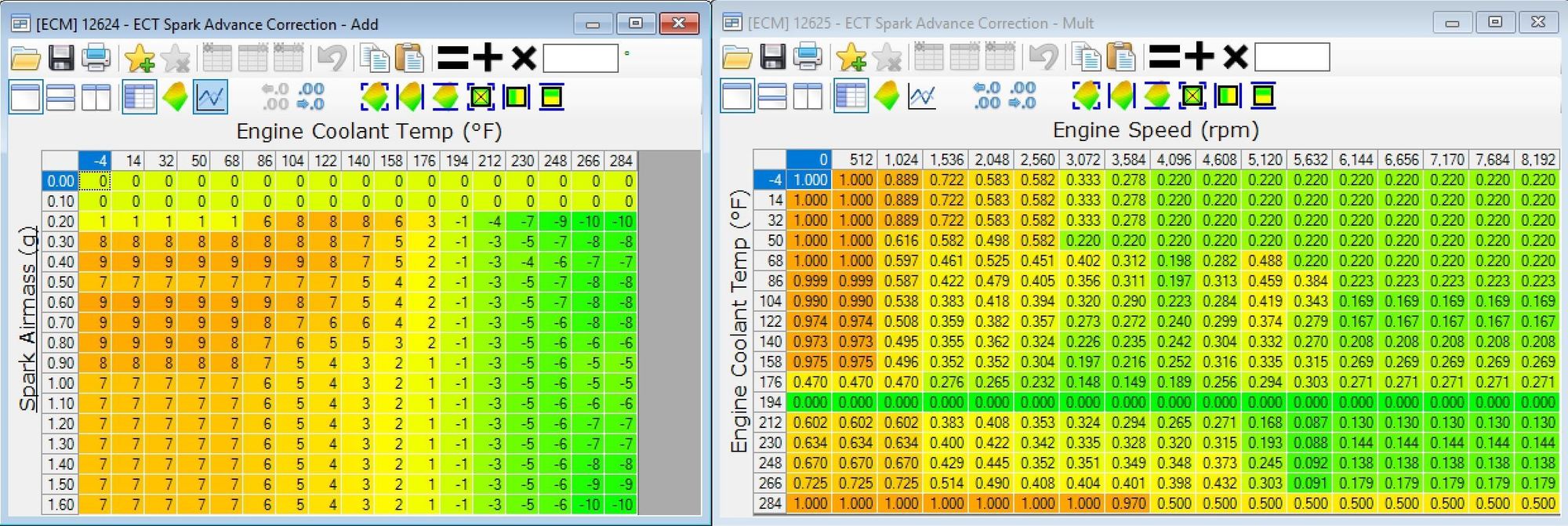

Also we have tables that show timing pull due to engine coolant temps.
