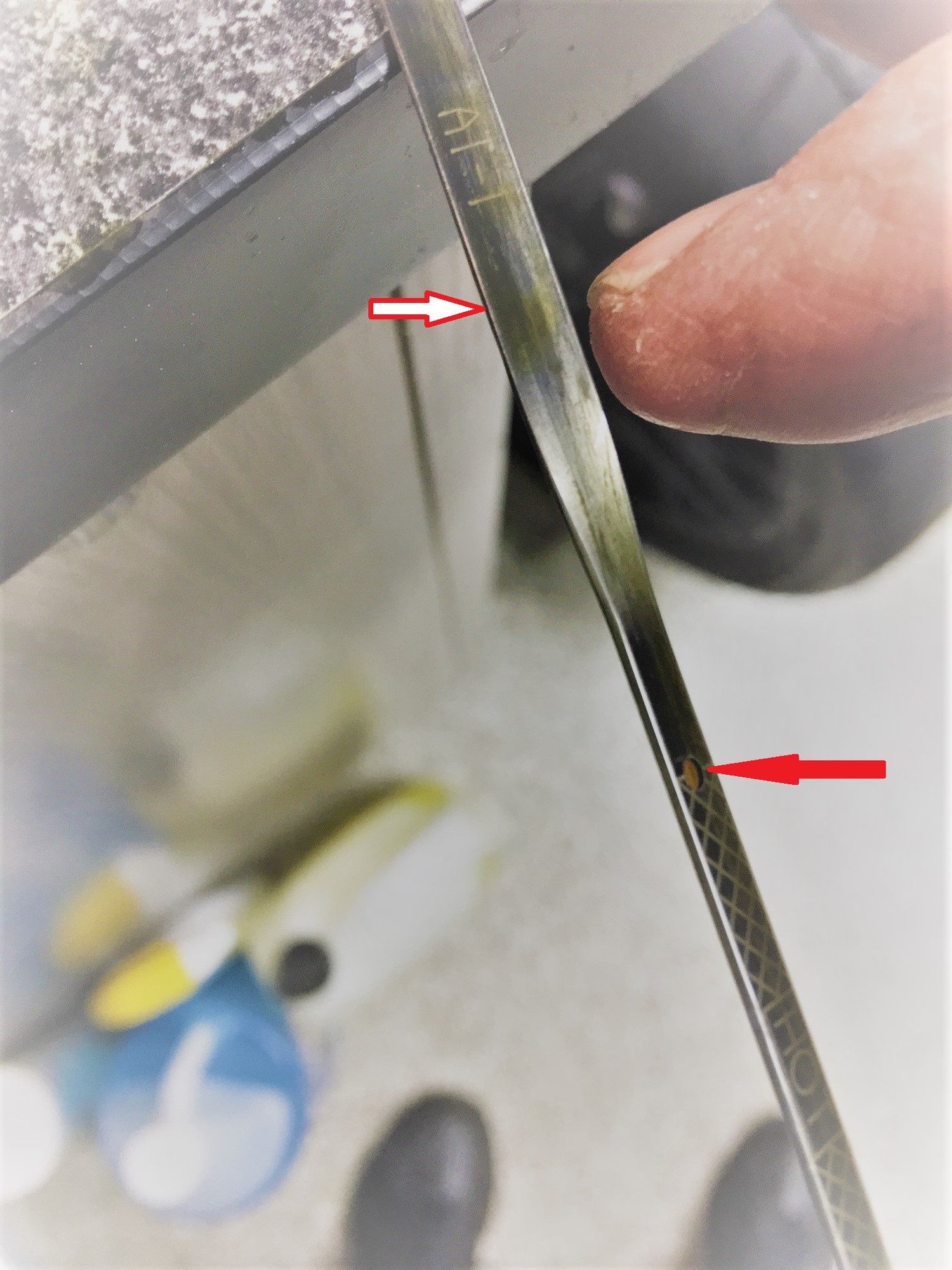

10 quarts don't overfill a dry sump car unless the previous oil wasn't drained properly. A little history of the dry sump:
It was introduced with the C6Z in 2005 and had a capacity of 8 quarts. In 2009 the ZR1 was introduced and due to oil starvation issues with previous years the capacity was increased to 10.3 quarts by adding a cone shaped reservoir to the original reservoir. This dry sump was carried over into the C7 model with the same capacity. The 2014 capacity is listed at 10.3 quarts, however, GM changed the capacity to 9.8 quarts by changing what was written in the OM and other documentation. They didn't change the hardware. When the car is used on track they want you to add a half quart of oil to bring total capacity to 10.3 quarts to reduce the chance of bearing starvation in corners.
I regularly track my car and keep it at the 10.3 quart level. I have no issues with oil consumption.
Here is a picture of Page 12-2 from an early 2014 OM showing the 10.3 capacity of the dry sump system on a Z51.
This picture shows the oil level when 10.3 quarts of oil are in the engine. This was taken after the engine OIL Temperature was brought to above 175 degrees before turning off the engine, then waiting 5 minutes to make the measurement. The lower solid red arrow indicates the top dot on the dip stick and where you would expect the oil level to be with 9.8 quarts of oil in the engine. The upper white filled red arrow indicates the level on the dip stick that is reached when there are 10.3 quarts of oil in the system.
When I check the oil I use the AT-1 Characters stamped into the dipstick as a reference to determine how much oil is in the engine.
Bill
