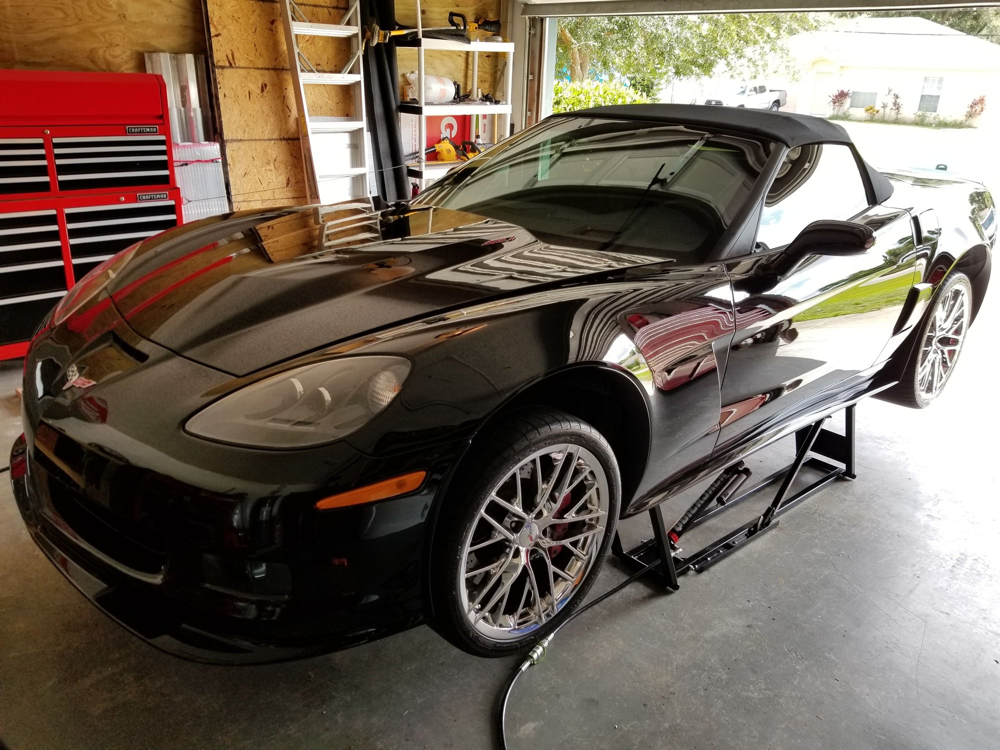

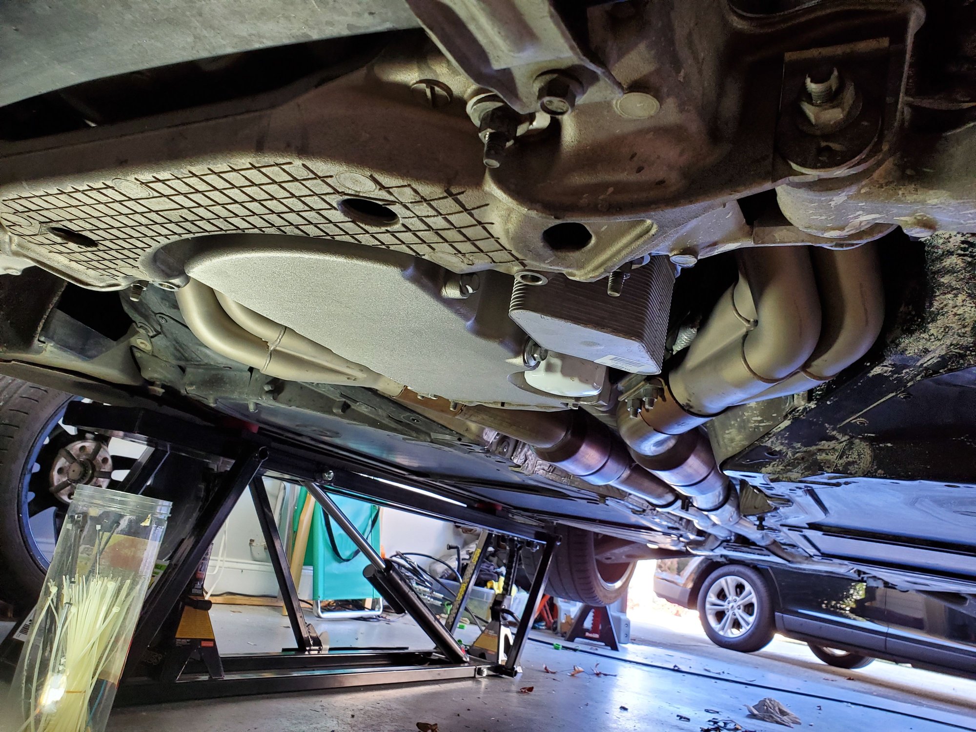

Thank you very much for posting pics. This is very helpful, but man, it still looks tight against those side skirts.
nope not at all .... plenty of clearance with the blocks and pucks
Remember the jack is well inside the skirts ...

I guess my eye sight is going to crap. Lol
Nah , its not a good picture but you can take my word for it, plenty of room , easy to setup

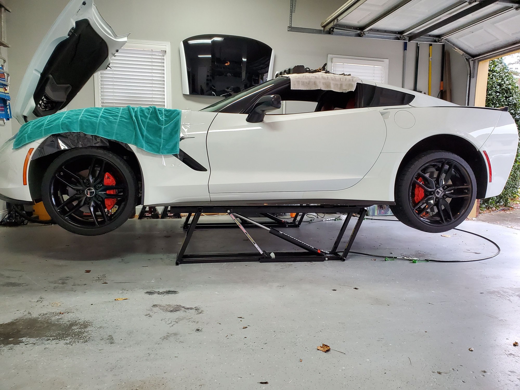

I have used my QuickJack 7000 on my previous C6, C7 Stingray, SS, Avalanche truck and wife's Cruze with no issues. I park my C7 Stingray, NOT lowered, over the QuickJack when not in use. The front air dam very slightly drags over it when pulling in and out of the garage. Great piece of gear. Not a worry in the world it will collapse even if it looses hydraulic pressure thanks to the cam locks. Good luck.

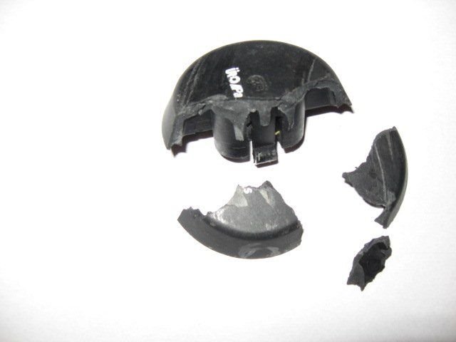

To those who are interested in Jack Pucks a word of warning DO NOT get the hard plastic ones that some CF forum vendors sell. First time I used them and it broke and almost caused the jack to cut into my fender. See attached.....

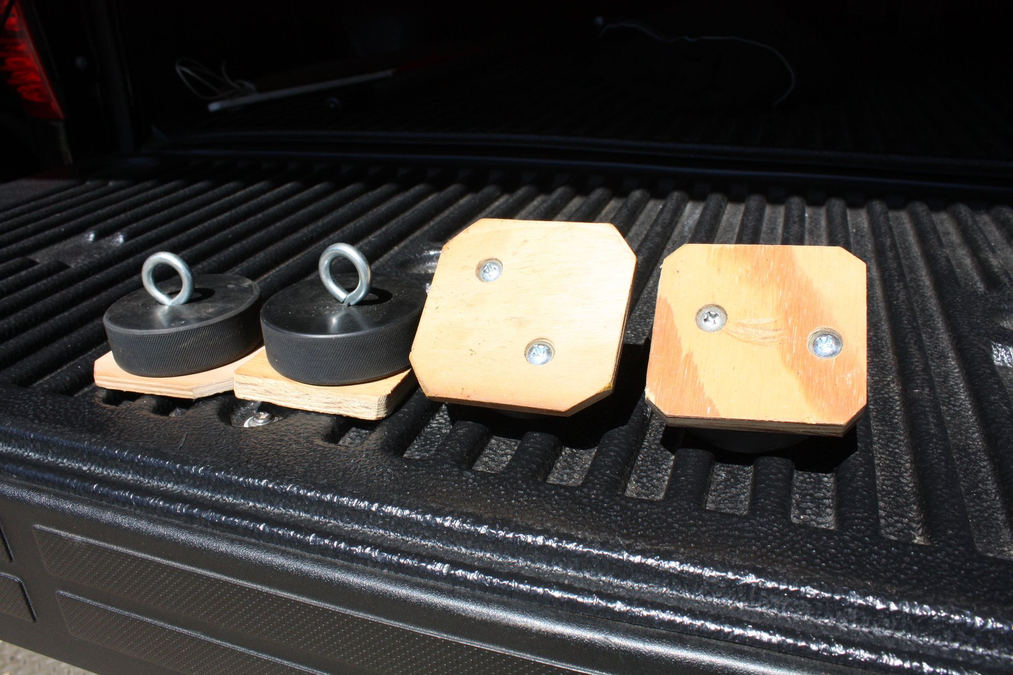

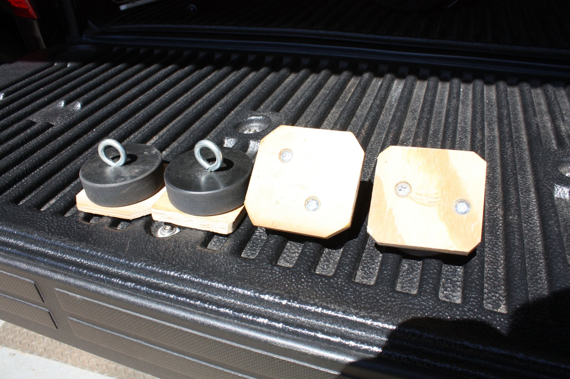

Once I get my 7000 I will work to make a safe combination to lift the 'Vette. I made these pucks ( with the info. I received here from our generous members )

Originally Posted by Vette Ski
Thanks,
Thanks,
Rich
I use pucks and eyebolts. Mine just don't have the wood piece. The only thing I don't like is how the rubber blocks sag in the middle. I need to cut some steel plates to spread the load out a little more. I have plenty of room though, even with ACS side skirts.

Jeff,
The reason for the wood was for them to fit inside the cup of my floor jack. So you would put a piece of steel between the rubber on the jack and the puck ??
