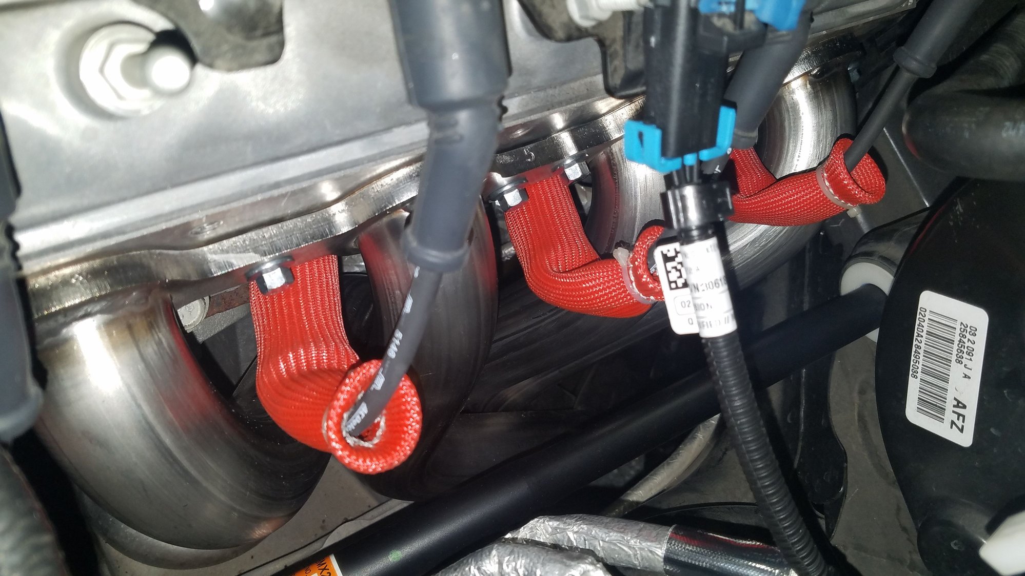

1) Look for USED American Racing, Kooks , Texas Speed or another well fitting well built Headers...

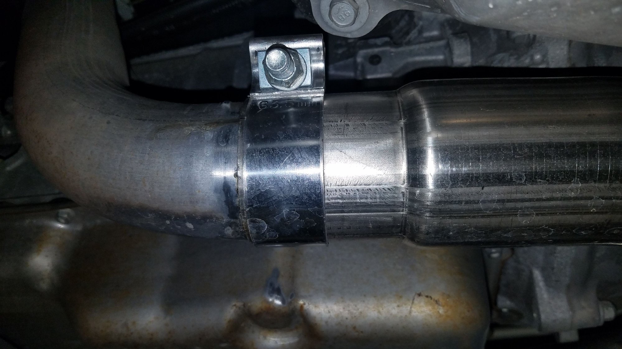

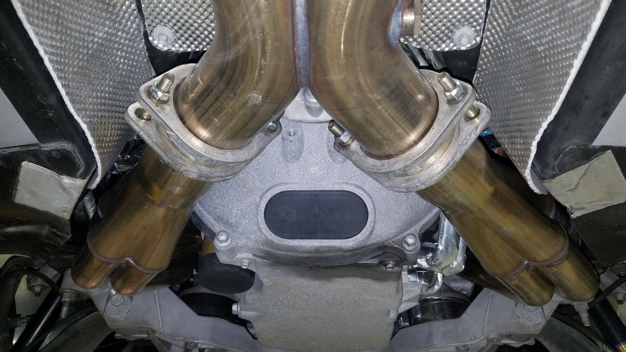

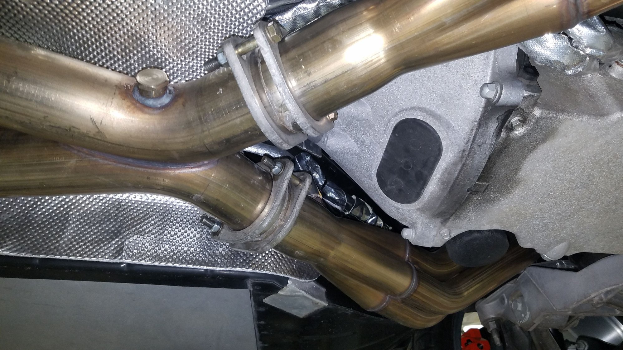

ARH 3" Catted X-Pipe
ARH ! 7/8" Stainless
ARH 3" Exhuast Pipes Reduced to Fit the 2 1/2" NPP Grand Sport Mufflers
ARH 3" mated to 2 1/2" NPP over the axle pipes
