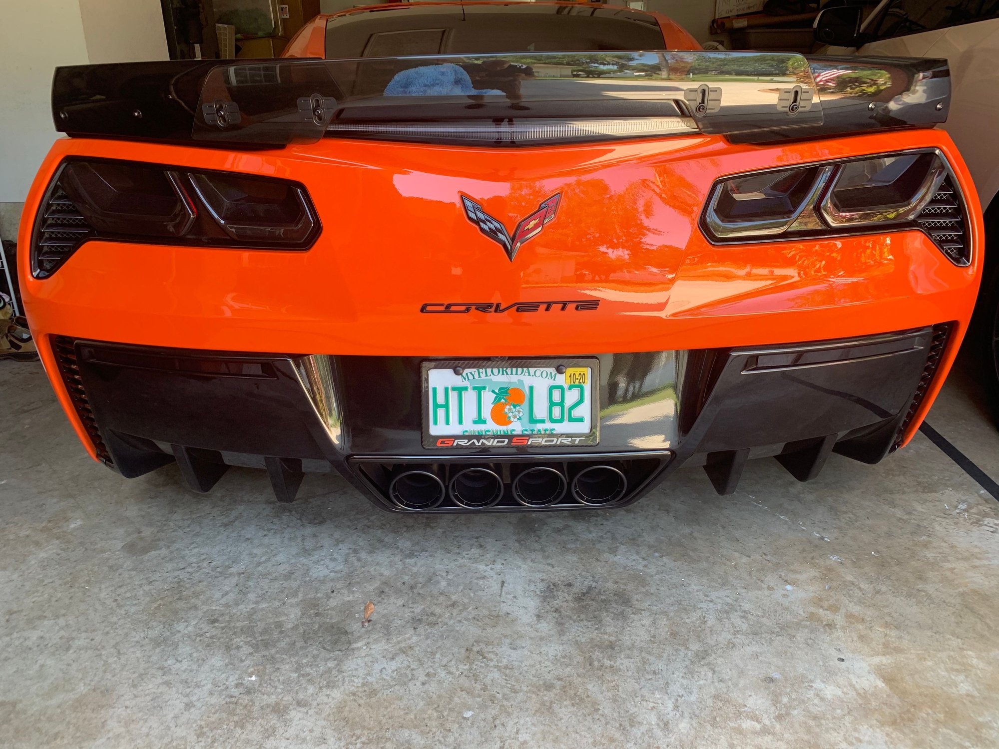

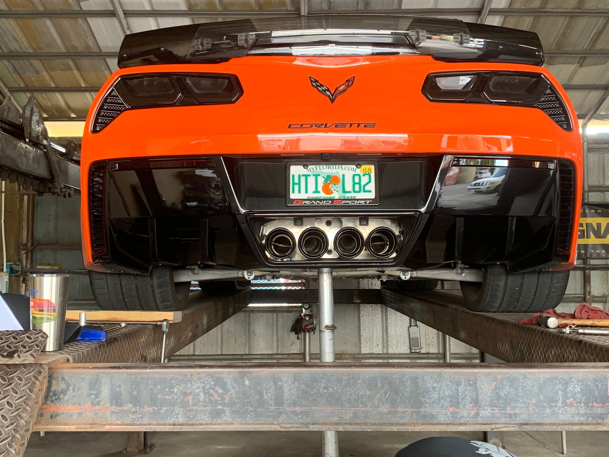

Ok gents just got back from muffler shop and it started pouring down rain so I did not get a chance to really put it thru the test. Here is my initial opinion:
From the moment you “cold start” with the Borla Stype (NPP) and hear the sound there is no mistaking this is another level of tone, not just from a volume perspective, although it is louder than OEM NPP by at least 3 orders of magnitude (give me a day and I will have a video up), It’s the robust deep “Burble” at idle that puts a smaller on my face. The tone between 3k-5k on the needle is sublime...truly. It’ s more toward what you’d here from a stang’ , deeper, nastier. No drone I could here inside.
I am 95% happy despite the hassles I have experience. The other 5% is to tweak the tips better, I did not want the Muffler dudes to touch that aspect of these given what I have been thru.
I am attaching a quick shot I took, please do not add insult to injury and overstate the obvious, I need to ask those that have been down this road the best way to do the adjustment so if you have suggestions that worked ...please share.
The powder coat came out great, I changed the color/type at the last minute, from Black “Matte” to “Gloss” to better match the carbon flash trim.
Finally I reached out to Borla CS, who gave me the email of Chris @ Borla to relay my experience to and he has responded with a very sincere “we will take care of whatever costs you are out of pocket” email. I was not looking for any $$ back but he offered. Additionally he said he was having a meeting with QC to figure out how to better protect the tips on shipment.
I hope this helps ......despite hassles ...would do it agin in a heart beat !!

Looks great. And yes, you certainly need to align those tips.
Question...... What made you decide to powder coat instead of ceramic? Will powder coat stand up to the 400* temps you saw the other day?

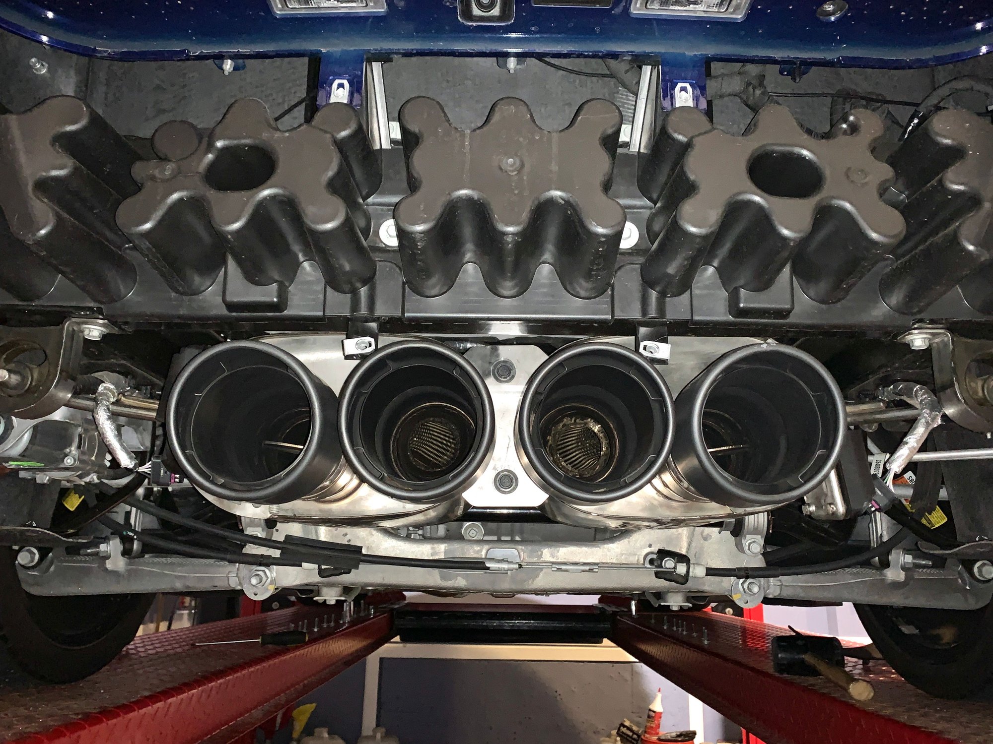

Hey bud!
here is that alignment guide that @ShadowGray19 and I spent a little time on awhile back. Show them this and they’ll be dead straight!
Here is how to adjust exhaust tips. It takes 2 techs to do it correctly:
1. The 2 - 13mm bolts on the center plate between the inner tips need to be loosened along with the 4 rear exhaust hanger bolts behind the mufflers and the 2 over axle clamps (loosen only, do not remove any of the bolts)
2. The first tech then pulls the mufflers closer together while rotating them (Counter Clock Wise for the right and Clock Wise for the left). This will lift outside tips away from the bottom of the valance and straighten all the tips out.
3. Once the exhaust tips are properly aligned, the first tech holds the mufflers in place while the second tech re-tightens the two 13mm center bolts between the inner exhaust tips.
4. One of the techs then re-tightens the 4 rear exhaust hanger bolts and the 2 over axle clamps and the job is done.
Note 1: If after the above steps, the 4 aligned exhaust tips are still too close to the bottom of the plastic valance:
** The first tech can loosen the axle back exhaust connections to the X-Pipe. The second tech pulls the pipes down together and holds in place. This will " rock back" the mufflers and pull the tips up a little.
** The first tech re-tightens the connections to the X-Pipe.
Note 2: As a last resort (should not be necessary):
** If the level pipe tips are still too close to the valance, the final solution is to carefully bend down the rearmost muffler hangers. A tech can do this by sticking a pipe over the hanger for leverage and prying down.
** The tech has to be very careful with this since a little bend will go a long way.

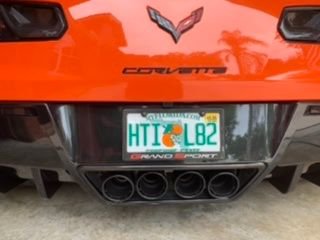

Thanks Brother...while I did not achieve perfection ( seems to me the flaps should be parallel to the ground a little more) , as far as spacing, distance of depth, I am fine with it. While I am sure others are more adept at it, to me, unless you are way back and eye level the detail of the flap position is not a huge deal.
Thanks agin for all of your help !!
Wow that looks GREAT! Congrats man!!!!
On the flaps, you actually do want them canted a little. The reason is because the NPP servos extend down quite a bit on the passenger side and if you run them totally straight, you will likely start digging them into the lower valance a little. I'd call it perfect (so long as they are the same angle).
That exhaust looks specifically great on the orange car. LOVE IT!
(I keep mine angled a little bit too)
