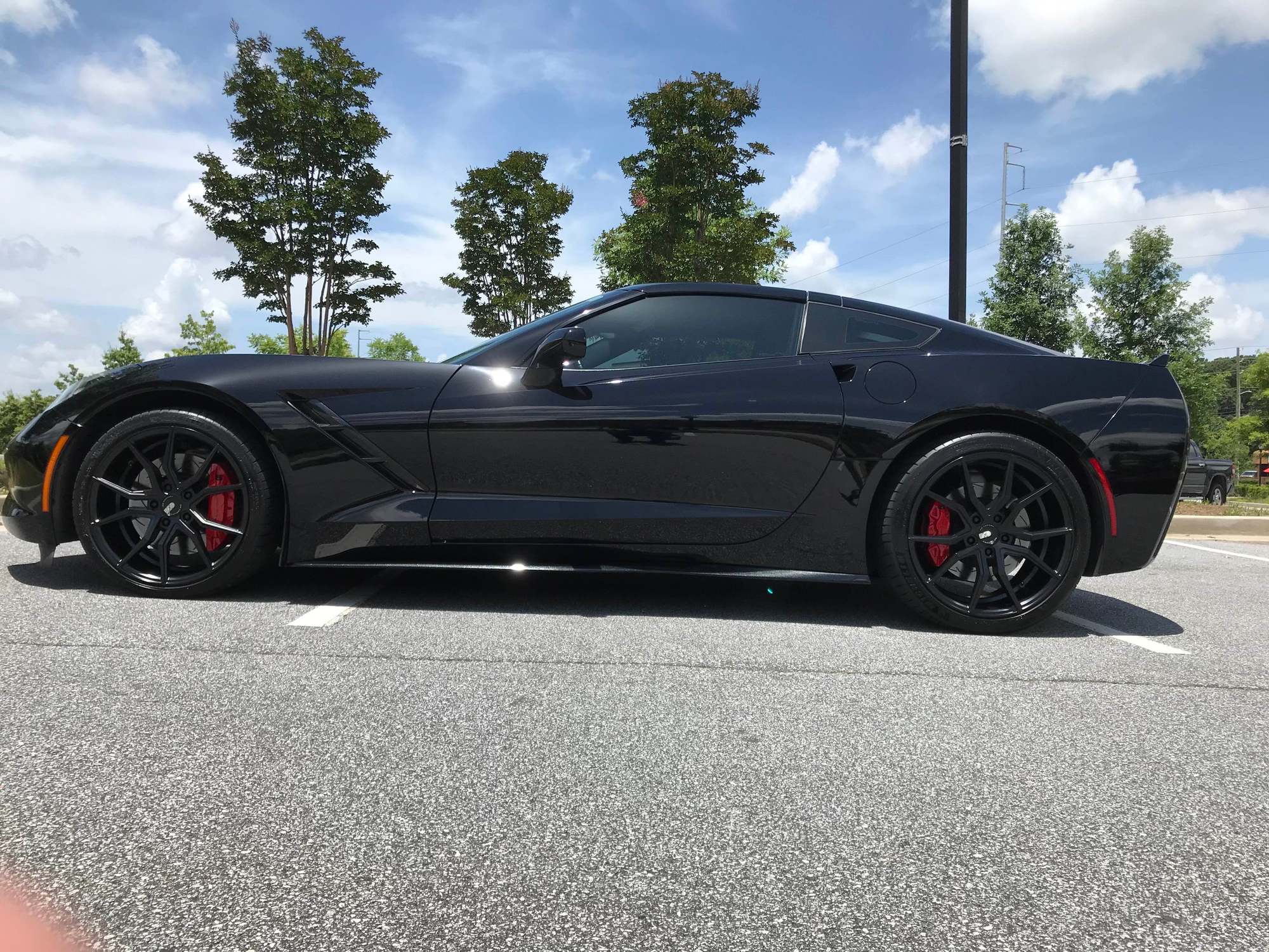

Z51 with after market rims and different tire sizes.
My front wheel wells have slightly more of a gap/spacing than the rears. I'm okay with the rears....but thought about just lowering the front a little bit...not all the way.
Any reasons why I shouldn't do or couldn't? I WILL be tracking...so, if just lowering the front is bad, I won't do it.
