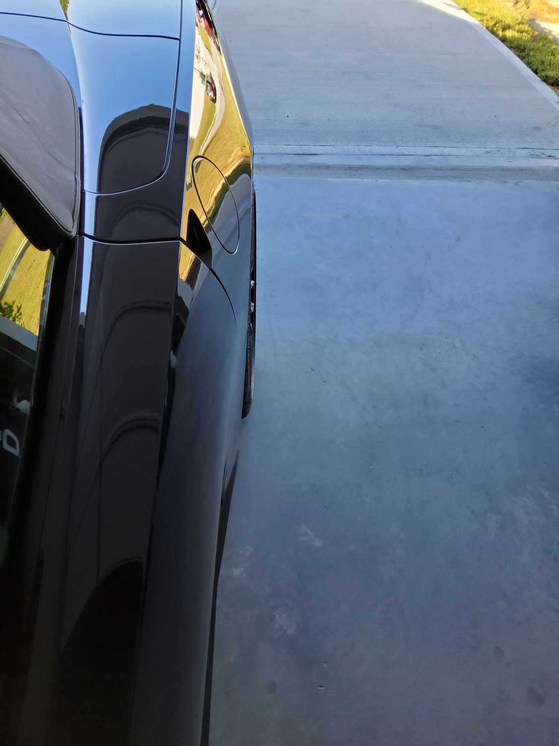

I got 5mm on all 4 corners since 3 years on my Z51 without any issues.
Tires just sit perfectly flush.

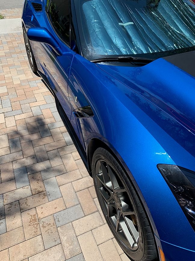

@Madmouse2895 I can completely understand your sentiment. I'm in the process of picking out some aftermarket wheels for the car and while this is an exciting time, it's also very stressful. The spacers, if done correctly, can easily satisfy your need for the time being.
@sTz Thank you!
@Tuf2Pas Indeed. 6mm front and rear. The car is fully lowered on stock bolts with a DSC Sport V4 controller and their street/track alignment specs. I was able to achieve quite a few 1.25+G turns without any rubbing. This is a non-Z07 car. This car will also see track duty. As for why I didn't get a Z07, it largely came down to the fact that I knew I was going to get a DSC setup (might get their Tractive shocks) and a few other aftermarket suspension goodies, along with Girodisc steel brakes regardless so, I just didn't see the glaring need if I was going to tinker with the handling dynamics.
These are shots of when I went to the Tail of the Dragon with my wife (she's even driving in one of the pictures). You can see the suspension travel and how close it gets at that kind of lateral force. Checking through my PDR data and even through the Cosworth app, we were able to verify that we did indeed hit the majority of these turns at the aforementioned G rating. After returning to Florida, I took the wheels off, not only to clean them from that long drive but also to check for any signs of rubbing. There was none.

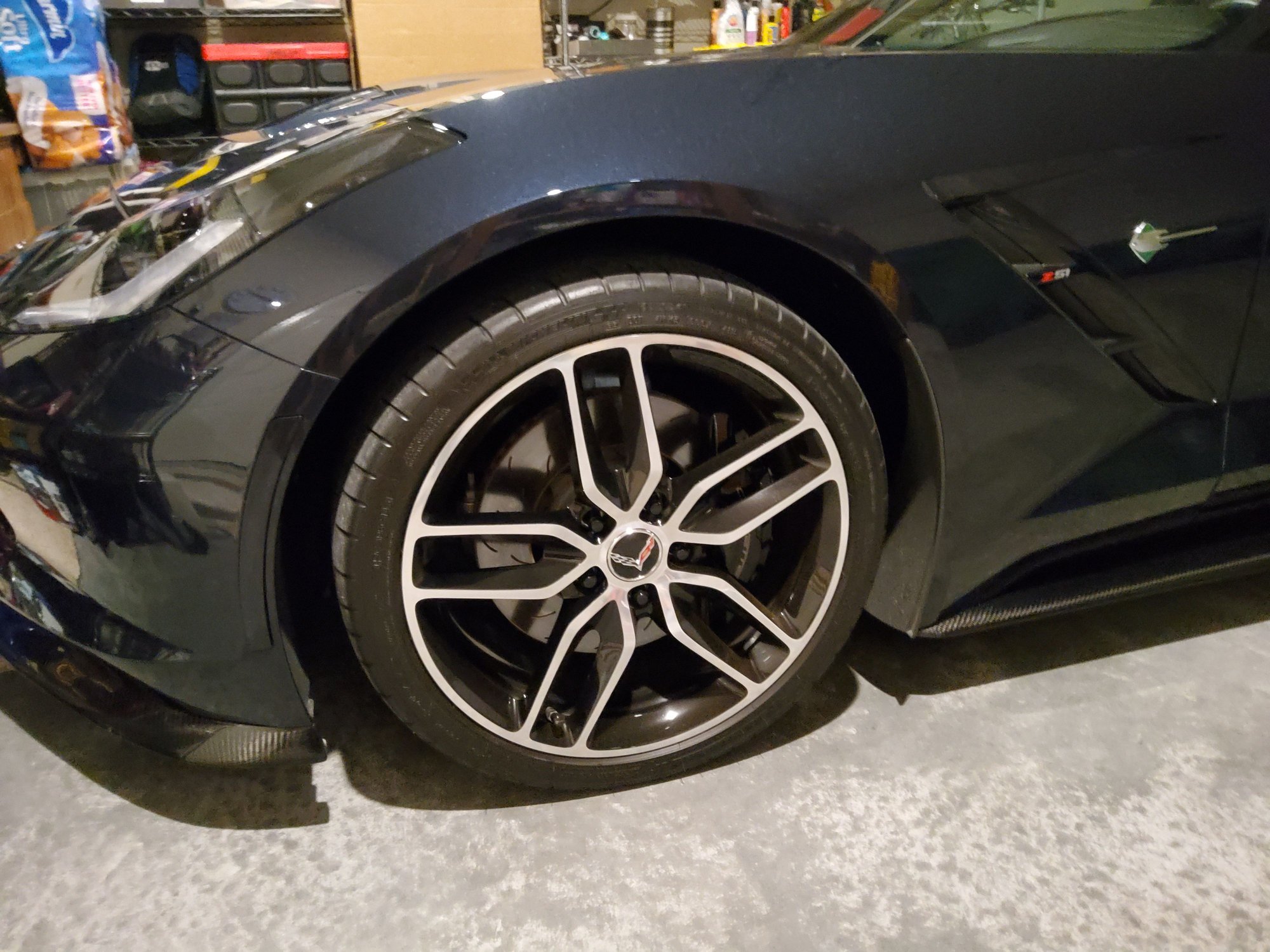

These are aftermarket wheels (AR924) on my Z51 which are 6mm front and 4mm rear further out when compared to OEM. So very close to the 5mm all around that @Benwish posted. This gets the tires flush with the fenders. I get a tiny bit of rub but only on track. For reference I'm fully lowered on the stock bolts and running wider tires (265 front / 305 rear). I don't see any issues with just street use.
