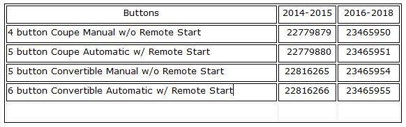

After some research: There's 8 different type of key fobs I can order?
pre 2015 at 333 mhz and 2016+ at 434mhz?
Then it breaks down to:
Manual Coupe
Manual Convertible
Auto Coupe
Auto Convertible

1) you need to get the proper fob for your model year and transmission / roof type
2) you can match a used fob to your car as long as it meets (1)
3) the metal key in the fob is purchased separately. An existing key can be duplicated if the shop / locksmith has the correct side cut machine, or can be provided by a dealer based on VIN
4) there is NO programming in the fob
5) your Vette can be matched to up to 8 fobs. Only fob 1 and fob 2 will trigger memory functions in 2&3 LT/LZ trim levels
6) instructions on how to add a fob are in your owner's manual and in a thread up in sticky notes
7) if you have a 2or 3 LT/LZ you need to use the longer procedure to add the fob. Otherwise the new fob will be #3 and not have memory functions
8) a dealer should not really need more than 30 minutes to add a fob (less than that, but allow some time for getting set up) so no more than $$$ 1 labor hour at the absolute worst

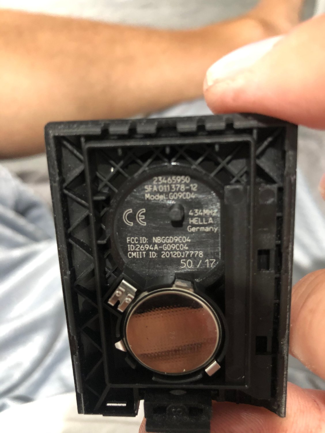

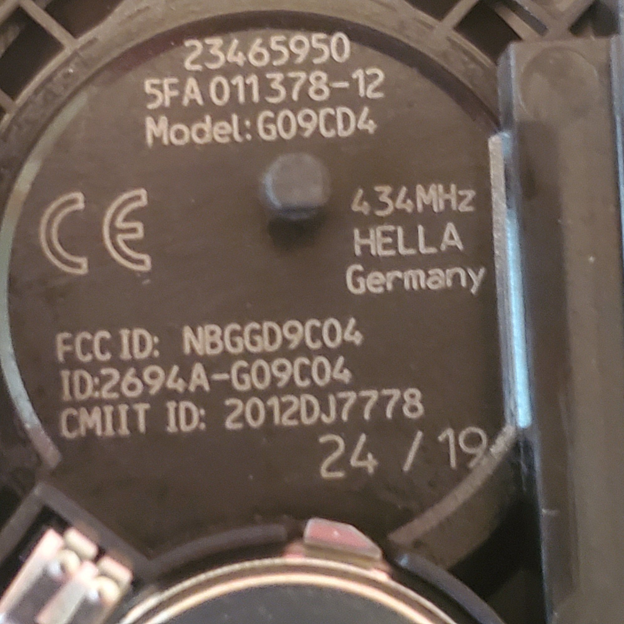

Dude,
There is NO programming in the key fob. The "programming" is in principle no different than pairing your bluetooth phone to the car. All of the "programming" done on the car using the metal key in the rear lock cylinder just tells the car that the fob in the steering wheel slot is authorized and that commands from the fob should be acted upon. The fob has a unique id code that the car stores, just like every cell phone has a unique id code. Part number, device ID, and other info is inside the fob by the battery.
In post #2 I gave you 2 sources for programming instructions to do it yourself. RTFM.

This is for my m7 2019 z06. My understanding is that the number of buttons and fcc id is all that matters
