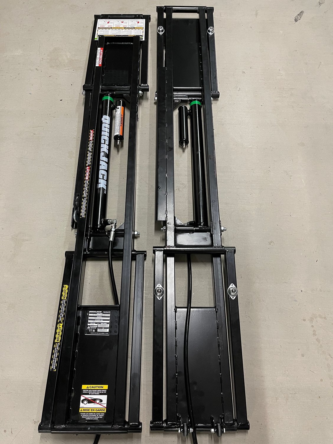

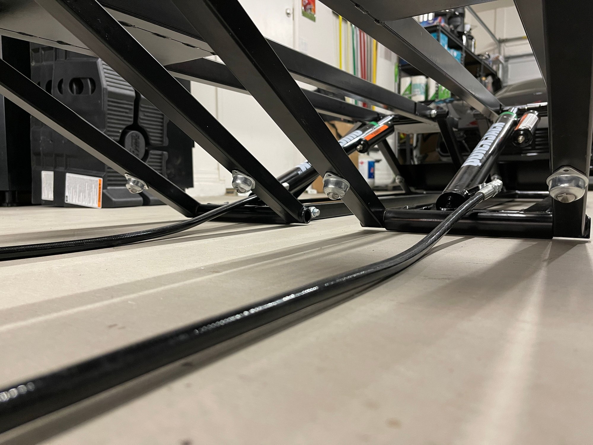

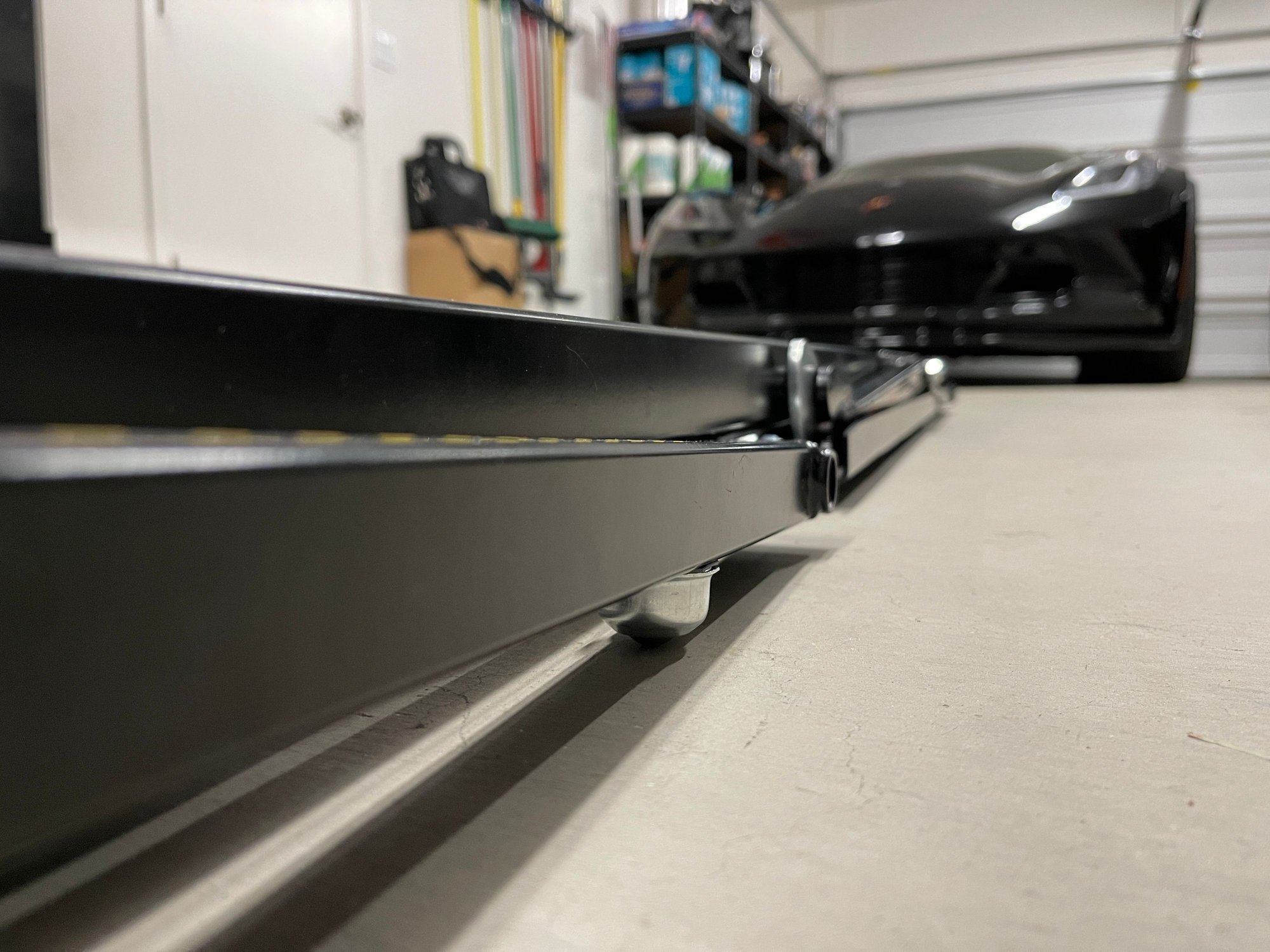

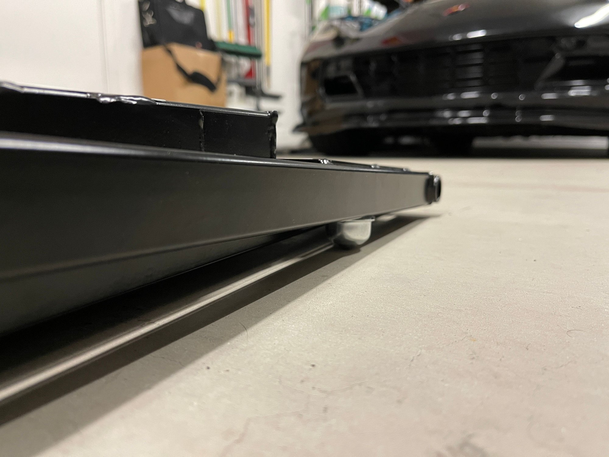

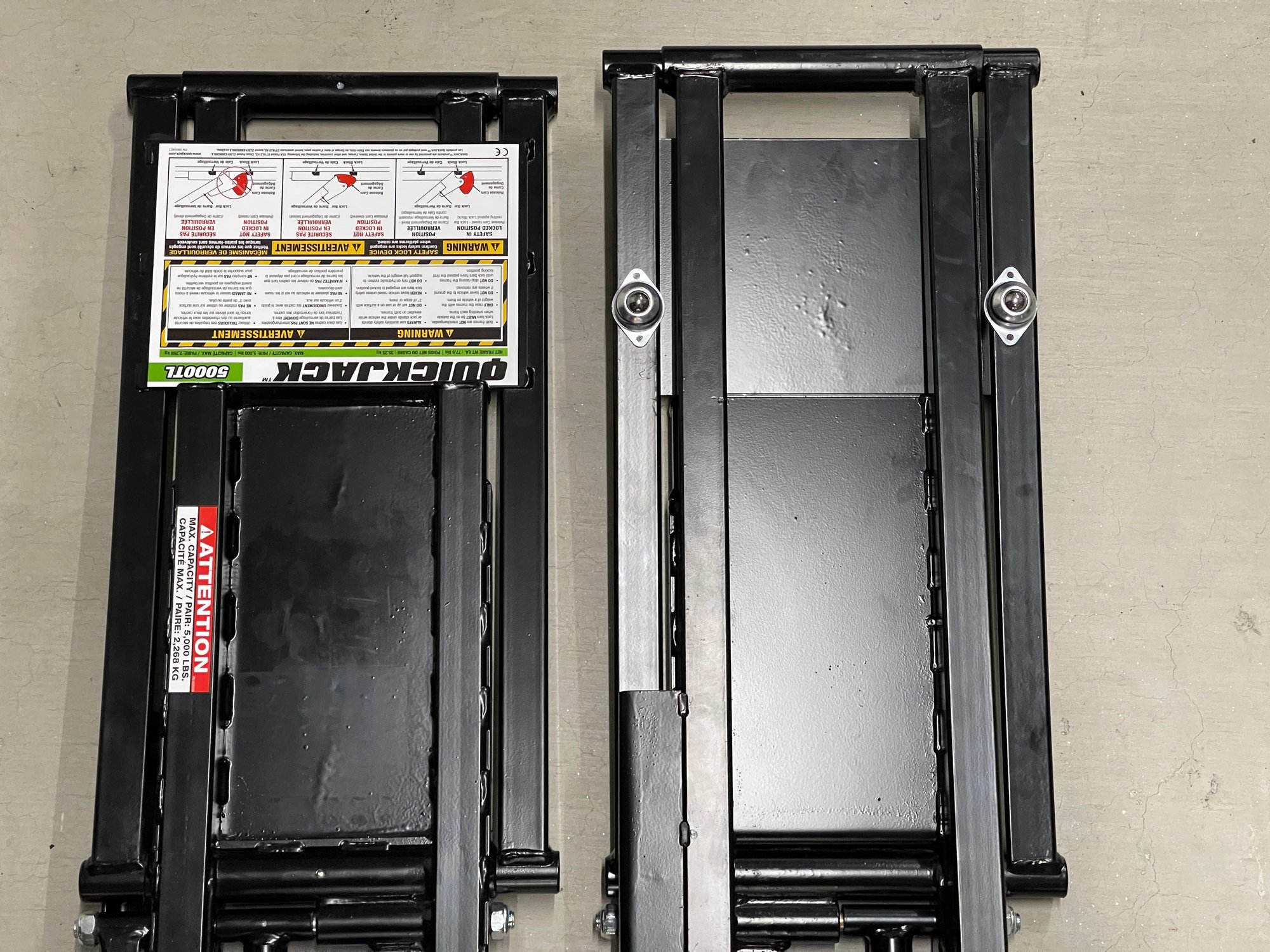

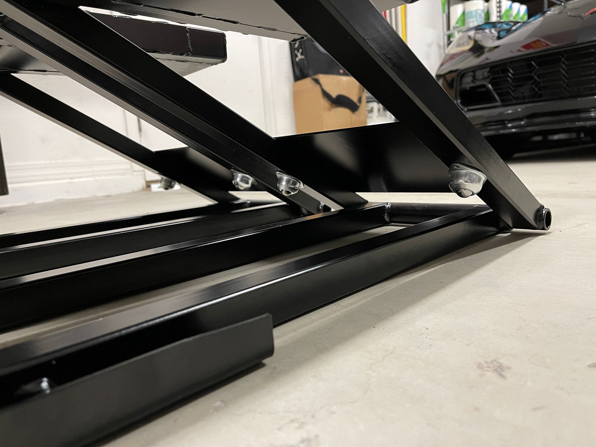

The modification works great! Couldn't be happier that it's easy to move while they are in the fully lowered position. No more scraping/dragging/hard to move lifts. It brings the bottom off the ground 1/4" so it can be moved around easily under/around the vehicle. I tested it out to ensure it slid under my Vette, and it did with enough clearance to get under the rockers and under the pucks. Easy and cheap hack that I can't believe QJ doesn't do themselves or at least offer. I can create a separate post if the mods want it on its own. I have a few videos below the pictures showing the movement where it raises the platform off the ground when lowered so it moves easily and puts the platform on the ground when raising so safety is not compromised. They also go up against the wall and do not hit the wall when using the QJ mounting hooks. PSA, no frame rails were harmed or damaged during this. DM me with any questions, I would love to help.
Items used:
  • Eight Harbor Freight 5/8" ball casters (/www.harborfreight.com/5-8-ei...ing-67067.html)
    • The casters are slightly wider than the frame tubes, so I left the outer edge flush. There is still enough surface to grab the tube and not interfere with movement.
  • Gorilla Heavy Duty Mounting Tape (Home Depot https://www.homedepot.com/p/Gorilla-...5002/308910063 )
  • 16 3/8" Zinc flat washers (https://www.homedepot.com/p/Everbilt...2324/204276362 )
    • These help fill the gap between ball recess and flush mount to the frame tubes
    • These aren't necessary to make this work, this is an OCD item for me. The casters are sturdy enough to handle this across four of them on each lift, this was a personal preference for me as it adds filler for the tape to adhere to the caster better.
The casters mounted on the outer frame tubes, not the platform that rests on the ground while lifting/lifted. I inserted two 3/8" washers into each caster to fill the gap and add further stability, then added a strip of Gorilla tape to the caster mount and trimmed it to form the caster mount. The casters were then mounted on the frame tubes the specific distances depending on the end. I used rubbing alcohol to clean off any oil or residue prior to applying the mounting tape.
  • On the polyurethane wheel side, they are 5+ from the lift joint closest to the hydraulic tube where the short hose is attached
  • On the label side, they are 6" from the end lift joint under the labels
    Left is caster as it comes, right is with 2 3/8" washers added to flush up the gap prior to mounting
    With Gorilla tape applied, trimmed to form
    Left one for perspective, right side with casters mounted on the underside outer frame tubes
    Left one for perspective, right side with casters mounted 5" from the upper joint nearest the cylinder
    Left one for perpective, right side with casters mounted 6" from the upper joint nearest the label
    Lift lowered onto casters (wheel end)
    Lift lowered onto casters (label end)
    Lift raised off casters (wheel end)
    Lift raised off casters (label end)

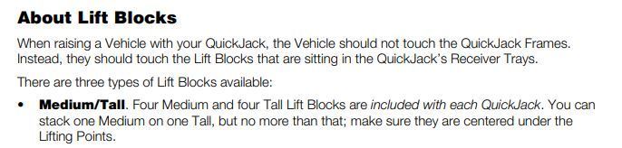

No worries about how to use or safety of the unit itself. I do not stack blocks, shocked ! to read above it is done. No don't stack the rubber blocks!!

I didn't come up with it on my own. It's in the manual. That being said, I'll never do it again.
