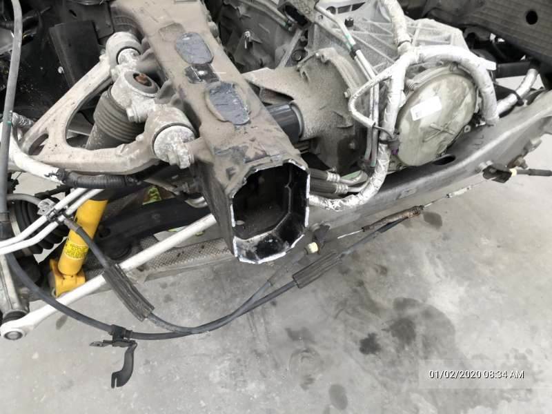

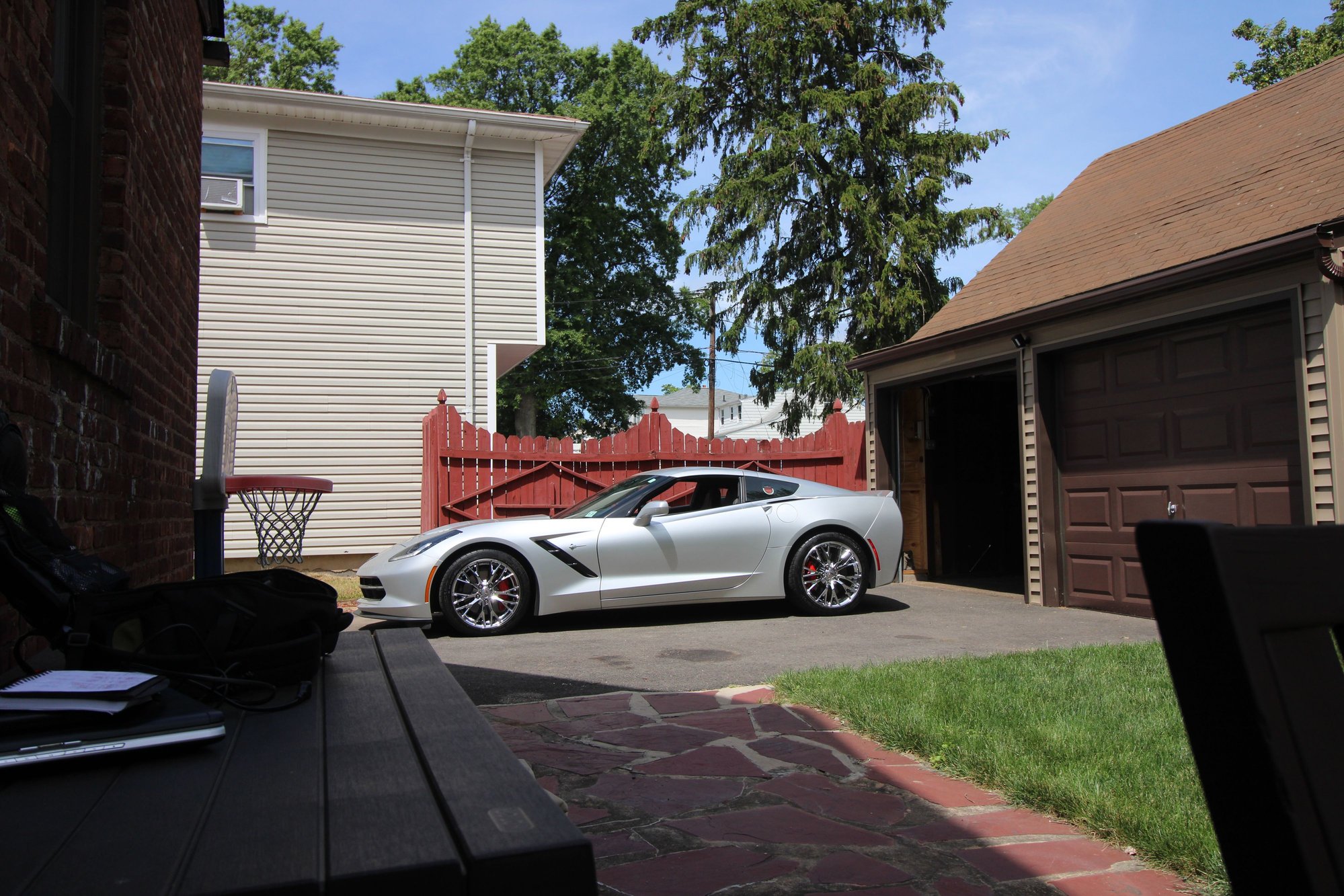

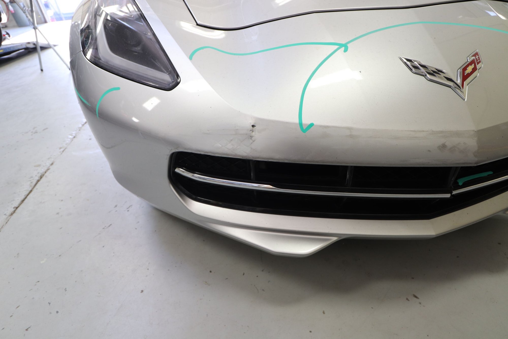

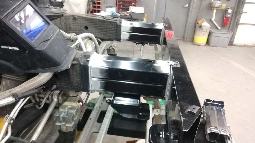

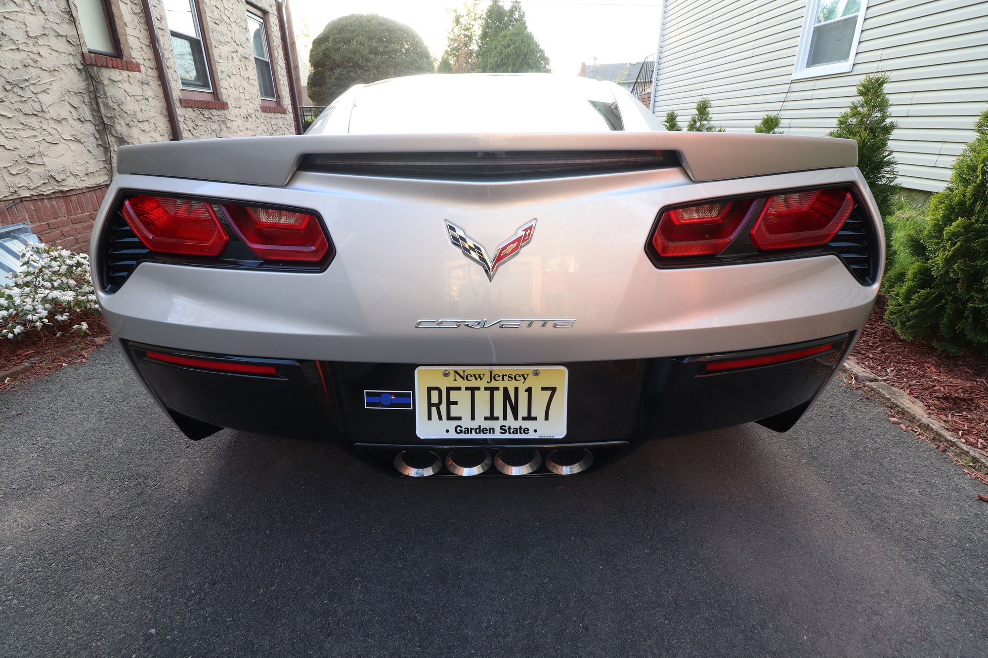

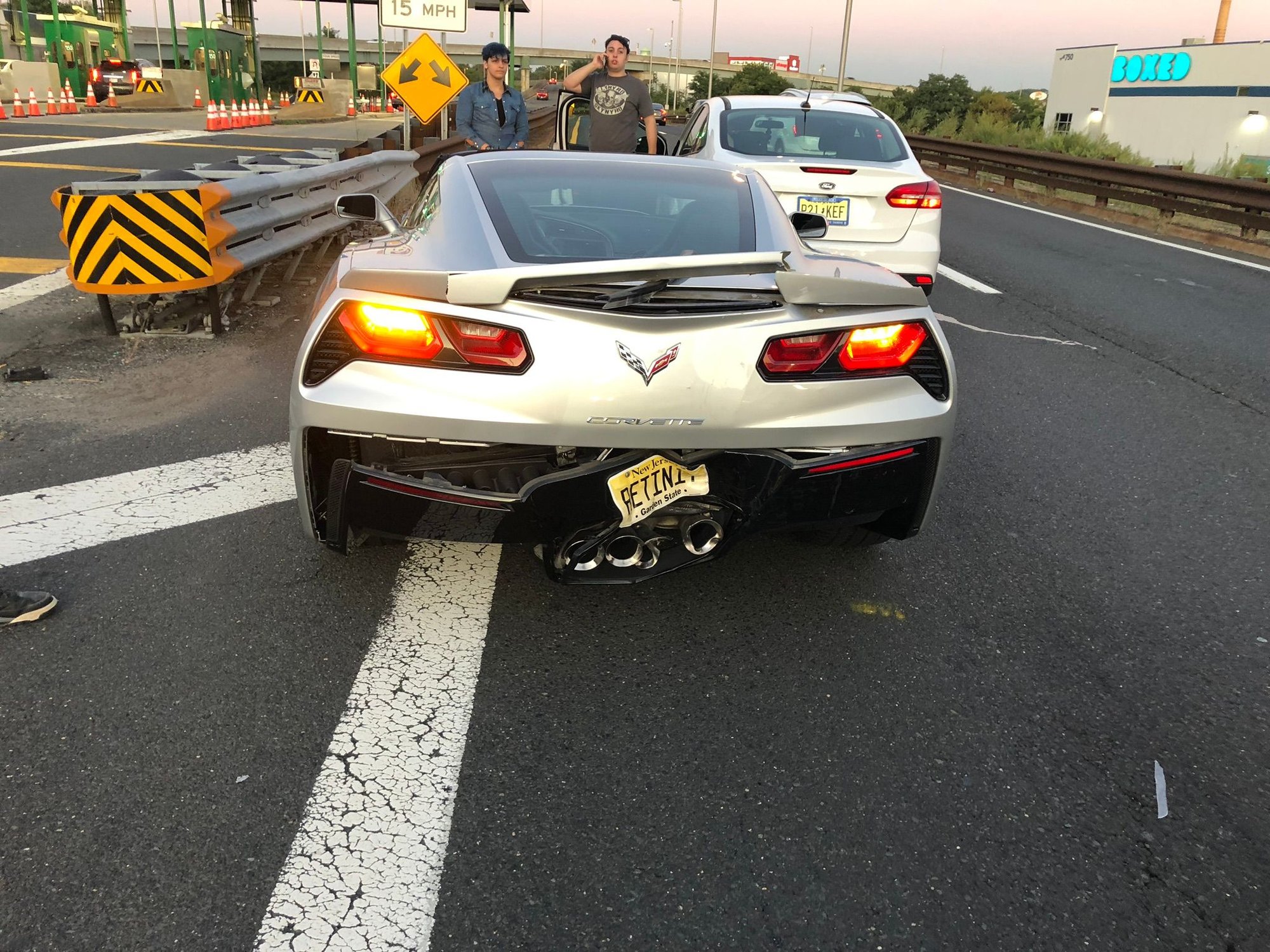

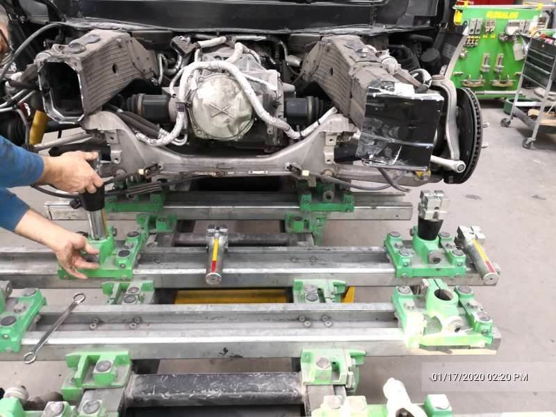

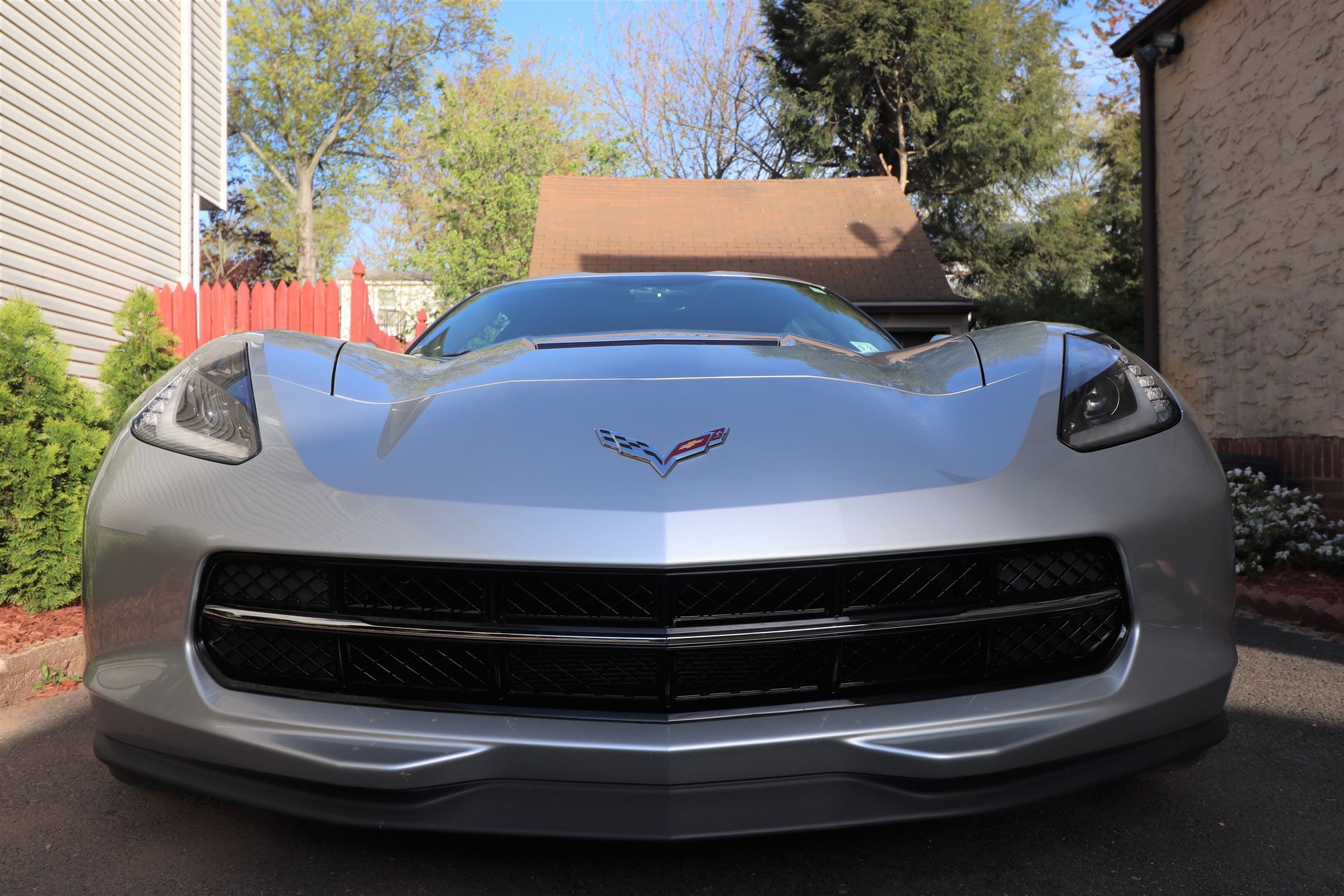

Monday it will be one year since I was rear ended by a box truck going fast enough for his air bag to deploy. My C7 was not totaled. The truck drivers insurance company footed the entire bill. I even had my deductible refunded. I had frame rail damage. Because of the GM strike then COVID-19,it took a lot longer than anyone expected to complete the repair.
The damage was fixed, my ‘16 C7 drives and looks even better than it did off the showroom floor.

Yours looks worse than mine! Country financial is the insurance company that totaled my car. Real bummer. I had just installed side skirts

As for a cracked frame repair costing so much that it pushes the cost of repairing the car over total thresholds that really depends on where it is cracked. The frame isn't a complete one piece frame. It is broken up into sections that can be replaced. Where that section is and how much work is required to access it determines whether the cost is all that high. Anything directly behind the fascia probably isn't a big deal. Anything that requires removal of the tub will require a hell of a lot more labor hours.
The car that was mentioned in a previous post that had to be totaled due to a cracked frame that was cracked at the junction where the tunnel, floor supports and vertical panel behind the seats join together. There is no way to replace that junction and it's associated parts.
Bill
As always Bill you are spot on. My upper and lower tubs were among the items that were replaced. They are fiberglass and it doesn’t take a lot of impact to crack them. We drive a car called “The Plastic Fantastic”! Those tubs by the way are glued together. The frames are in sections so certified aluminum shops can put most back together again.
