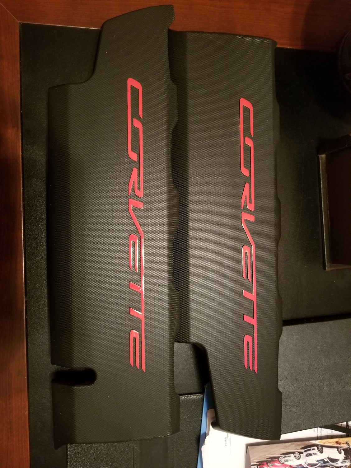

My 2017 (late 2016 build) started peeling this spring. I acquired a new set for a great price but would like to find something to help them last longer than 3 1/2 years. Any suggestions for a heat proof clearcoat?

Likes: 10
From: Bay Area, Ca.
These are gorgeous. Where did you get these?
