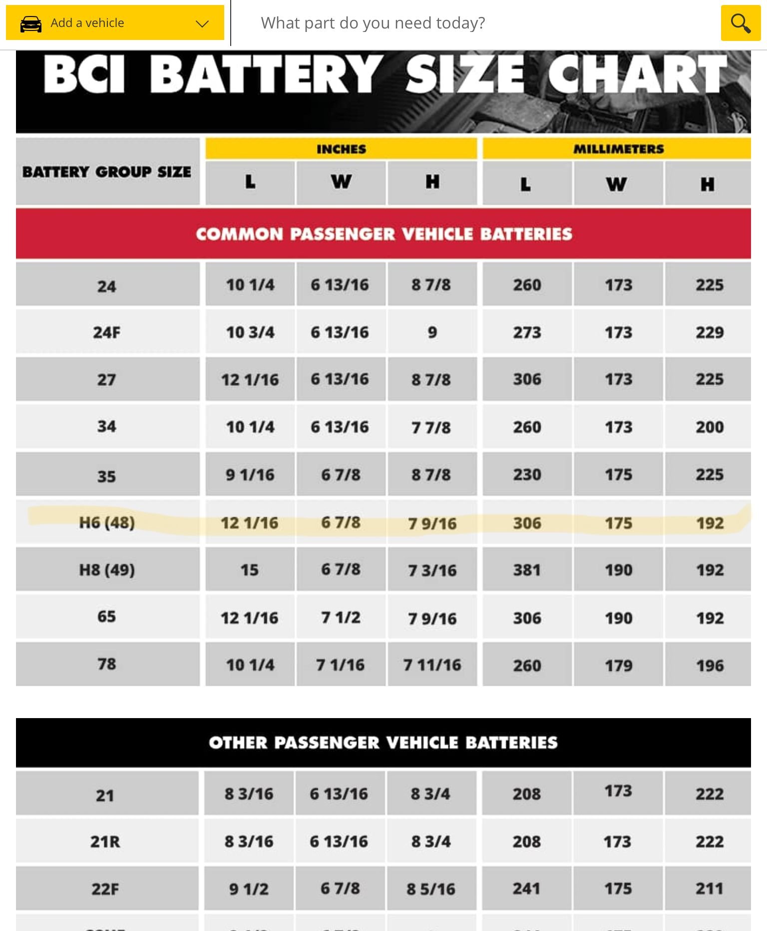

Default Battery Replacement Question
I read a bunch of the forum battery threads. Most seem to suggest the AC Delco. I can get it locally.
My battery is going on month 45 in a 2017 C7. I prefer not to wait until it needs to be replaced. I also prefer to do my own work.
I noticed a Champion Group H6 at Pepboys that is AGM and has a 48 month full price warranty for the same price. Has anyone tried this battery? My research indicates that an H6 is the metric exact equivalent of a size group 48. Is this also correct?

You're good with H6.
