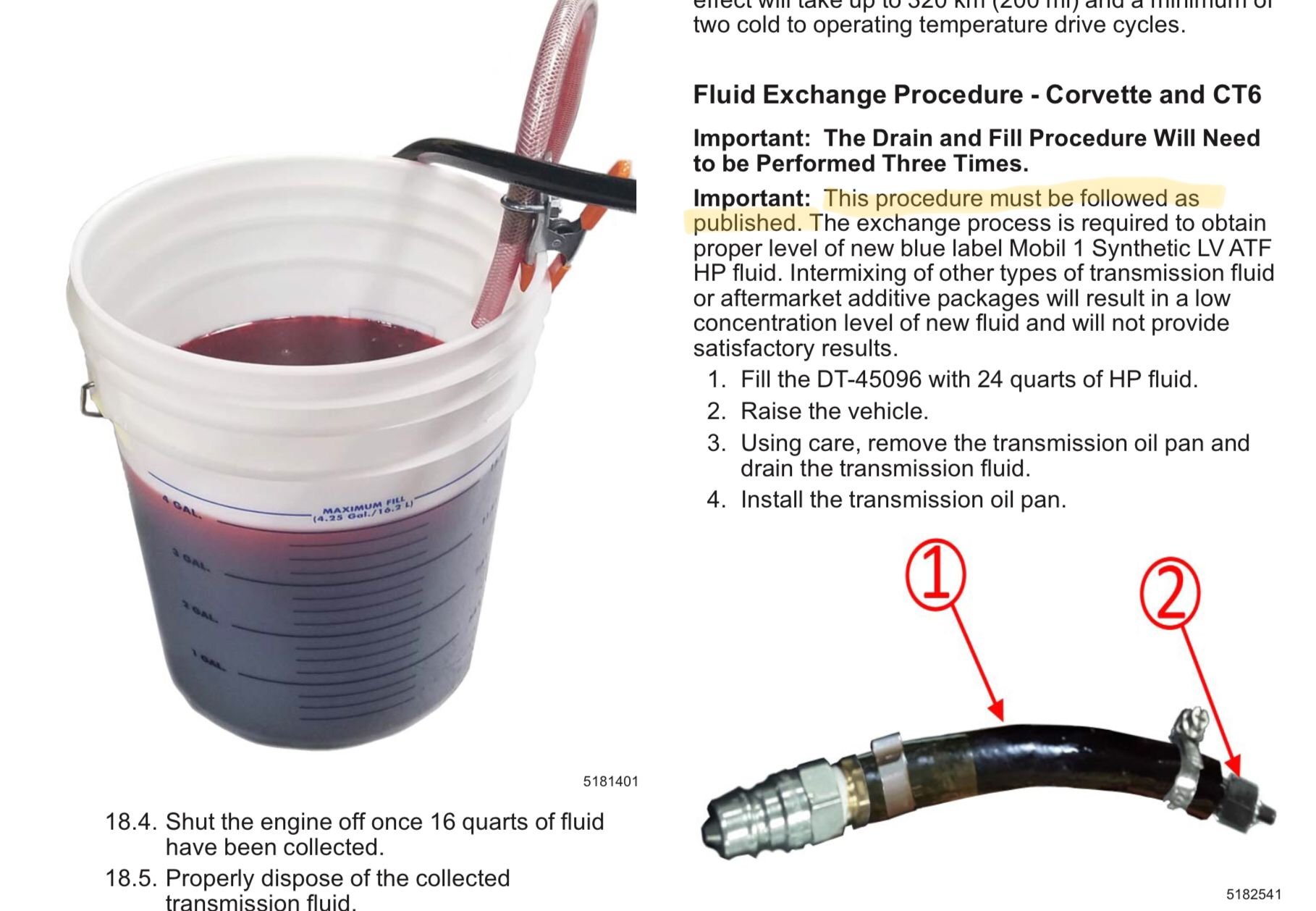

The biggest expense of this flush is the 24 qts of synthetic oil. GM allots just 1.6 2.7 hours for labor. Changing the oil on the A8 is just not a matter of popping a drain plug. The procedure is elaborate. You should read the TSB. The Corvette portion of the instruction is on the last few pages of the instruction. Most of the pages of instruction covers other GM vehicles. You should be aware of GM's recommendation in the instruction which I have highlighted for you in the pic provided. I would suggest you have GM perform this service.

Originally Posted by MMD
The biggest cost of this flush is the 24 qts of synthetic oil. GM allots just 1.6 hours for labor...
Corvette is 2.7 hours.
Old Nov 4, 2020 | 12:42 PM
919cw313's Avatar
919cw313
Joined: Jan 2016
Posts: 8,055
Likes: 2,694
From: New Mexico
2018 C6 of Year Finalist
Are you always this wrong?
(taken from Bulletin No.: 18-NA-355 Date: April, 2020)
Do you see where it says "ADD"?
1.1+1.6=2.7
Any other questions?
Edit: Where's your smart post? Anything else to say?
