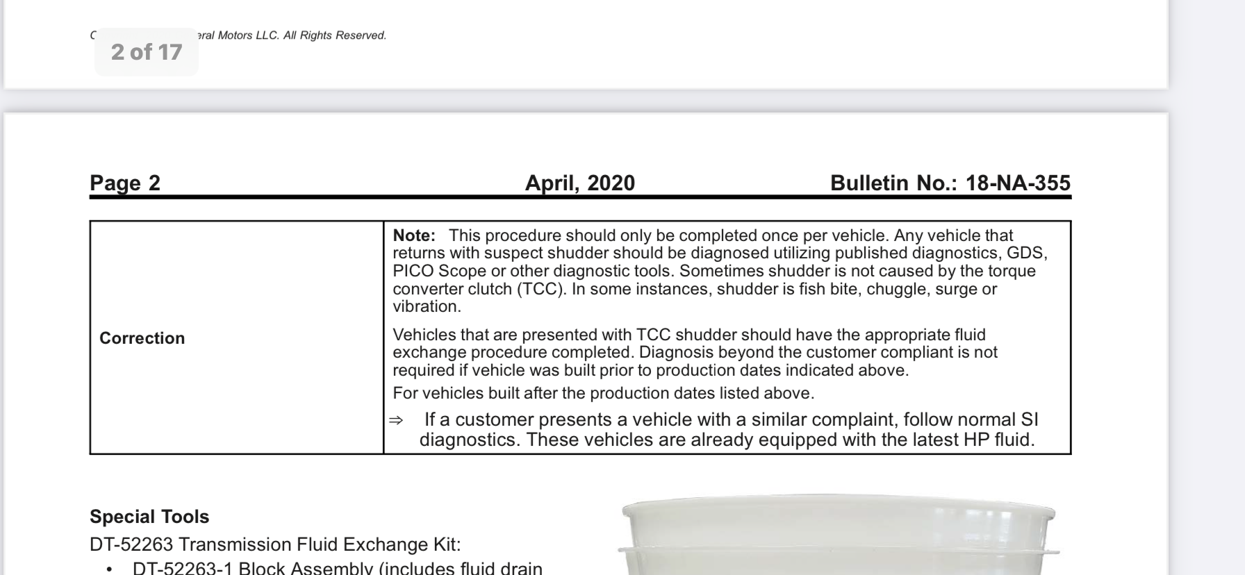

All you need to do is tell them your trans seems a little notchy in 1st and 2nd gear when the car is cold.That is a condition listed in the TSB to perform this fluid flush. The flush is definitely noticeable once it is done. You can feel the difference.

Might depend on your dealer. I had dealer do TF on my 17 GS. I called service manager ahead of making appointment and talked to him about bulletin 18 - NA -355. Told him I would like to have Triple Flush done to get correct recommended fluid in tranny to prevent any possible problems and possible cost in the future.I mentioned where in bulletin correction section it stated. "Vehicles that are presented with TCC shudder should have appropriate fluid exchange procedure completed. Diagnosis beyond the customer complaint is not required if vehicle was built prior to production dates indicated above." After our conversation service manager said it will be done under warranty we made appointment . TF was completed. So it seems there is some wiggle room if dealer wants to work with there customer . Dealer will get paid for work by GM so they get paid and in my case dealer also gets a happy customer. My GS was done in May and my 18 GMC Sierra has appointment this Thursday for TF, oil change and inspection.

It definitely should not. The TSB is very specific, as stated. If the dealer doesn't want to do it, call another.

I agree if you are presenting a car WITH TCC Shudder, but if you present your car to dealer WITHOUT shudder symptoms , there might be a gray area Bulletin correction section talks about car being presented with shudder complaint. I was answering question regarding cars being covered by bulletin WITH OUT symptoms.
