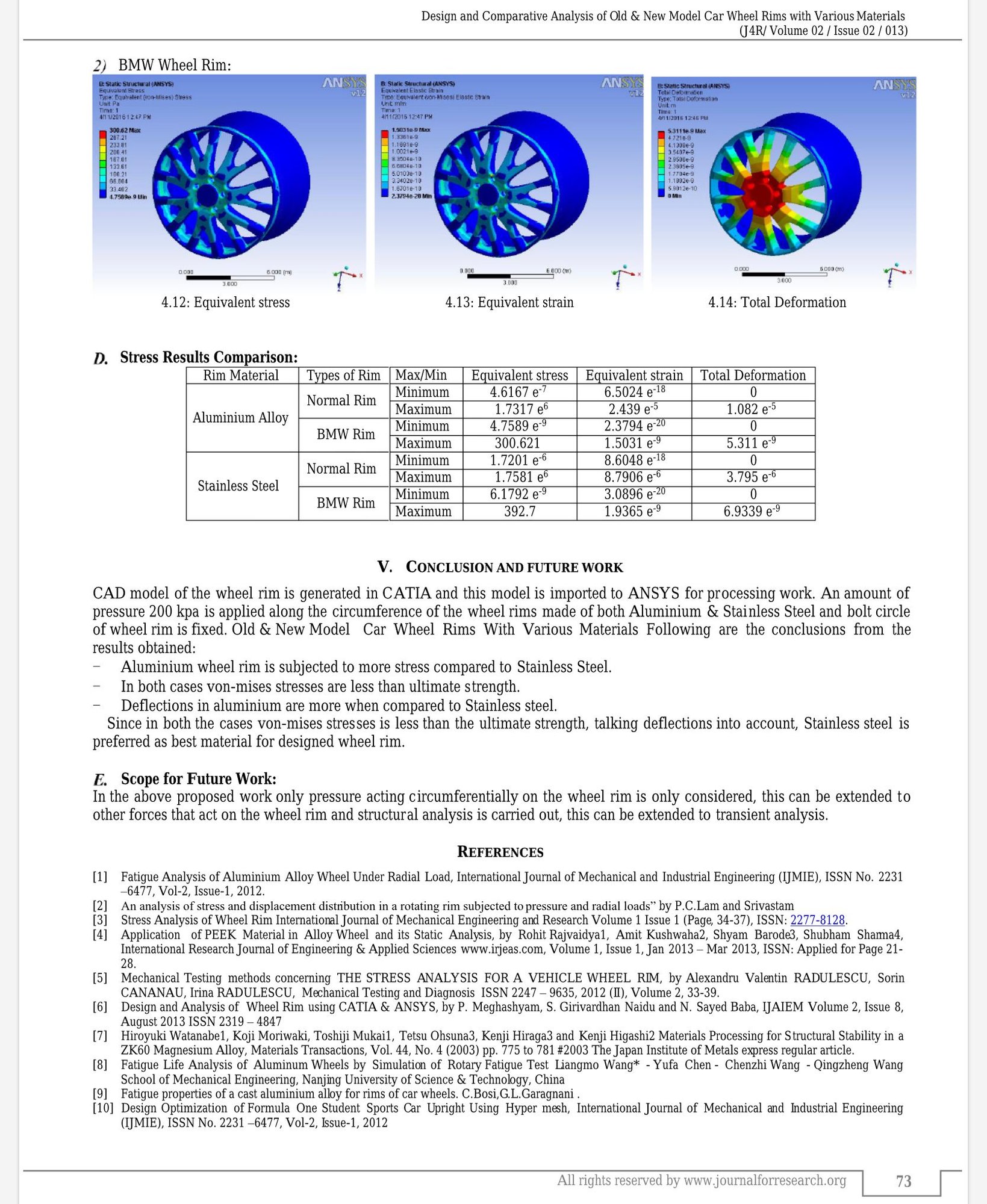

My related background has to do with aircraft accident investigation and much of that subject has to do with metal fatigue and and vibration analysis etc. Observing the wheels on the OPs vehicle did ring some bells in the realm of radial fatigue and I spent a few minutes doing some searches and came up with the PDF data in the attached photo. Not saying this is anything more than an example of where an actual investigation might or might not lead and the degree of sophistication required to reach any final determination. Also, this type of event might occur without any specific impact stress at the time of failure. One thing I know is that government types and manufacturers quite often leap to “operator error.” Why? Because it is often the fastest and easiest determination and almost always absolves the manufacturer and their suppliers. Again, looking at the photos and the OP’s descriptions, I can easily say that I have some guesses as to what might and might not have occurred but I can also say that I do not remotely have the ability at this point to specifically conclude who or what forces are likely at fault here. I certainly could not give testimony in a DOT or military hearing that the OP is or isn’t lying about what transpired or that he is simply mistaken about actual events or even the impact or stress history of the wheels. Until a metallurgical analysis is performed and a good number of real world wheel failures are also examined by experts for related deformations/failures I don’t believe anyone can reach certain conclusions at this point in time with the data before us.
