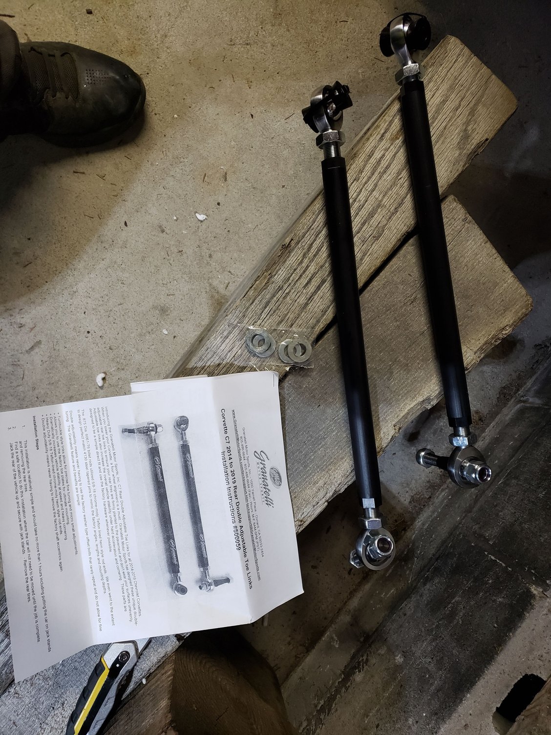

Not sure on the 500 miles,but I would give it least 300 per say or monitor it.You may find you will have to add adjustable rear toe links to get rid of to much positive camber in the rear.When the front settles in no additional parts needed.At least that is what happened to my GS

Then had to wait for toe link install return to shop to finish the alignment.
