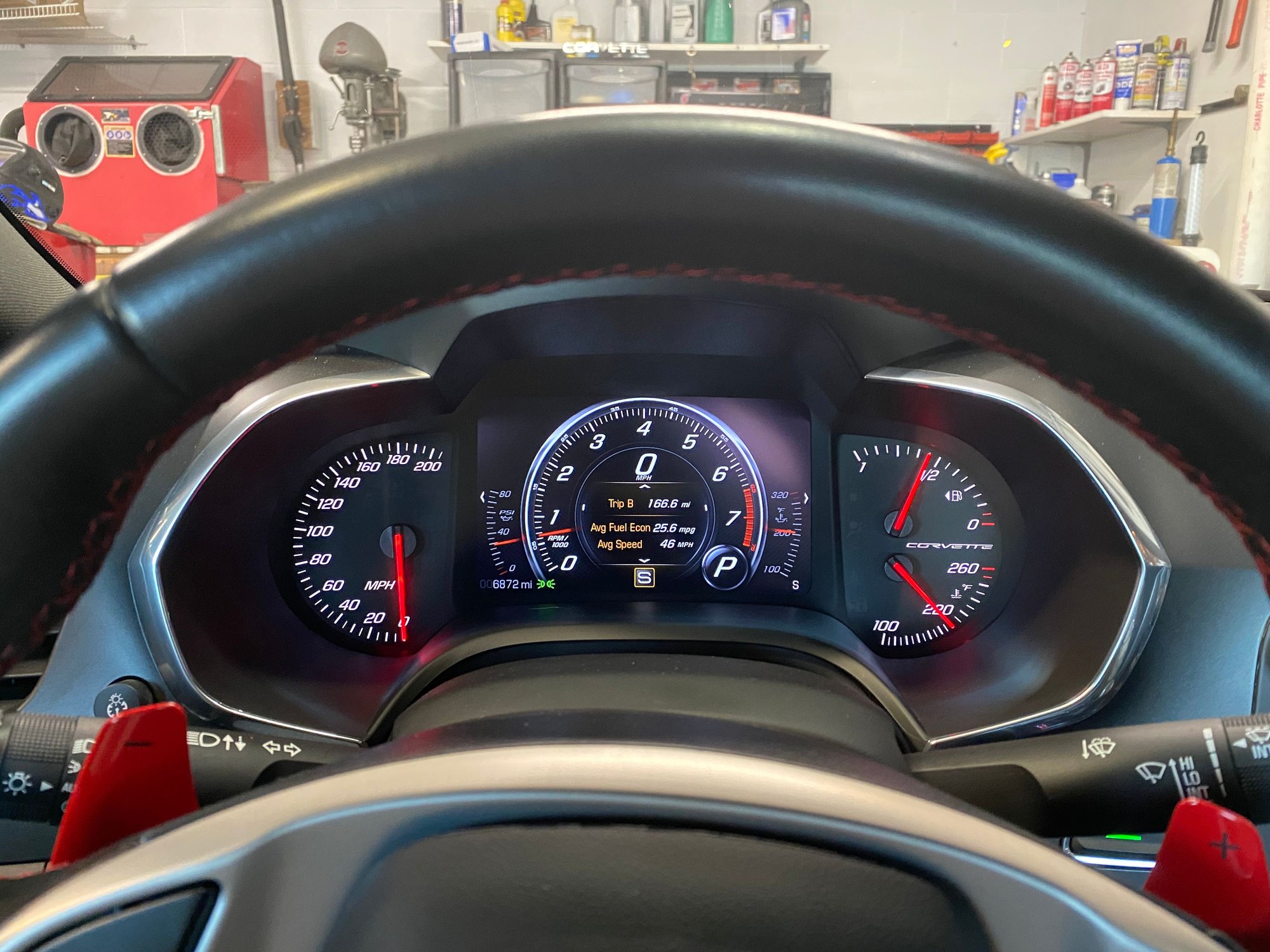

I finally got to try the Range Device out. While driving I noticed one surge or stutter from the trans when I accelerated. Almost like it tried to go back into 4cyl mode. It only happened once. The car stayed in V8 mode the entire time and it was otherwise fine.

Could have been a number of things .... but one thing for sure it was not the TCM commanding the 4 cylinder lock up logic which causes the shudder . If you want to be sure ... just leave the V4 - V8 indicator up on the dash display

Yes, after it happened, I pulled over at the mall and put the indicator up and it was on V8 the rest of the time. I'll be sure to do that before the next few outings to make sure everything is good. Next up the is the soler throttle controller.

Went on a decent trip today and got good gas mileage with it.

That's the exact MPG I get with mine
