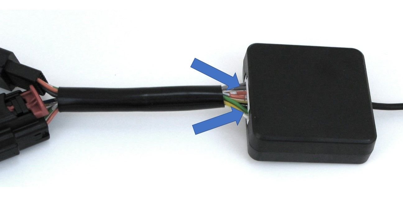

From: Canada
Originally Posted by jaiyenyen
Are all you connections tight, I have heard of a similar issue and the connections were not tight enough. I know when I connected mine there was a very clear click as they we connected.
I'll try that tomorrow, thanks. I sent an email to soler for some trouble shooting.
Make sure your fob is away from the car and the car has powered down before disconnecting and reconnecting.

Originally Posted by Iverr6
Got the controller today, installed it on the car, connections are tight. Started it up and it immediately went into limp mode with a check engine light. Any ideas why this happened?
Did you take your fob far enough away from the car so that the car would shut down totally before installing the controller? You have to wait until the car has totally shut down. Takes a minute or two.

Luzifer, sorry to hear that. Seems like it is an intermittent connection or wrong calibration. Please pay attention to this connector (white) and push it in with a flat head screwdriver (do not push by holding to the wires). Once it clicks it is very difficult to disconnect. Disconnect the battery for 5 minutes to clear all DTC's. Then reconnect and do steps 7-12of the attachment. If that doesn't do it, reach out and we'll replace it right away.
Do not hesitate to call if you need help.
I also got the same response from Soler, I just pushed the connector at the brake pedal, I didn't hear any click or feel that it went any deeper but so far it works as it should. So it was a bad contact.
Good, hopefully that does it, if not I would disconnect it completely than reinstall.
It was a bonehead move on my part. I didn't wait long enough for the car to completely shut down before disconnecting the throttle. I disconnected the battery for about 10 min and everything cleared. Reinstalled the controller and everything has been good so far.
