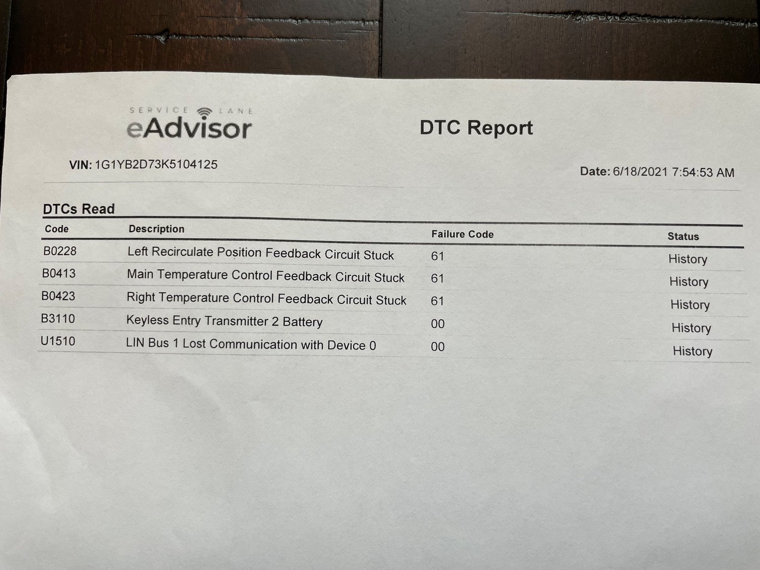

Update:
DOT4 brake fluid flush done, $144 with military discount.
The intermittent A/C issue logged the codes below. Had to schedule an additional appointment for a software reprogram/recalibrate to address the A/C issue. Also, look like it's time to replace the battery in the key fob. The last code he says comes and goes, not to be concerned with...
