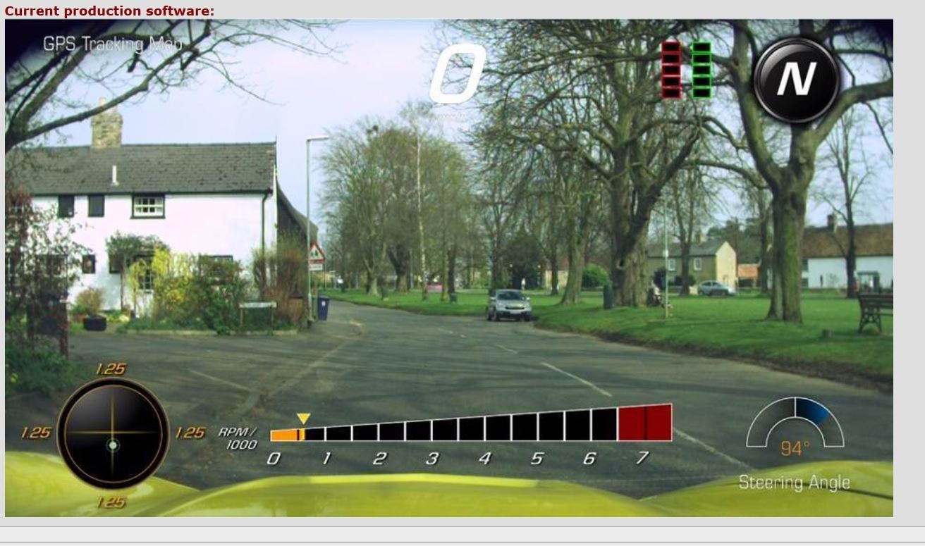

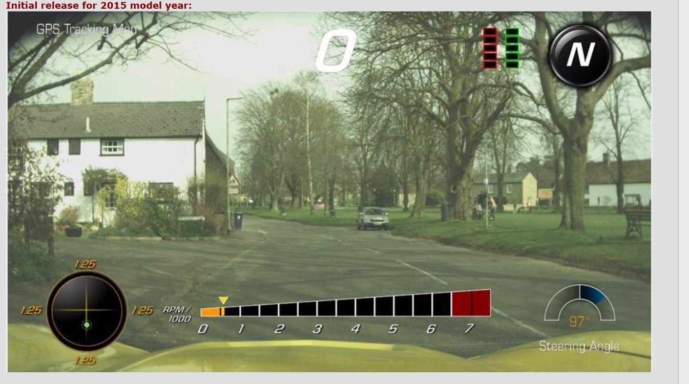

There was a software update in March of 2015, Here are the differences:

I am in NY. Those photos I took off the forum from a ask Tadge question. Maybe Tadge would know? lol
