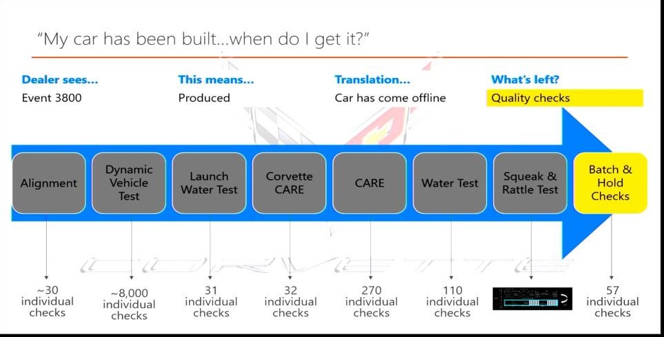

Your thought got me thinking. Anyone been to the Bowling Green assembly plant and actually seen the Corvette production line process? I haven’t.
Question is does BG leak test every vehicle with a heavy dousing of water spray, lights on wipers going etc. as part of the assembly process?
If true GM is likely recycling and reusing the water being applied during the leak test to the vehicles. There also may be high pressure air centrifuges blowing the excess water off the vehicles as they exit their respective leak test station/s.
If that’s all true it could very well be the first time the headlight lenses get their 1st application of internal hard water stains we are experiencing. Pretty average.

So there is apparently two rounds of water testing at Bowling Green Assembly. Here’s comments from the Corvette museum:
After the Dynamic Vehicle Test (DVT) is what’s known as Launch Water Test, a water test that is much longer than the standard water test (more than 250% longer), a supplemental water test to the standard test, was proposed by the plant and is not performed elsewhere. “When we bring a new vehicle to production, trying to seal a car up is more difficult than you might think. For all intents and purposes this test really submerges the car so we can find leaks.” Kai also shared that this particular test they can earn their way out of by making sure they don’t have leaks and reduce it to an audit.
Then following Customer Acceptance Review and Evaluation CARE is the normal water test with 110 different checks.
In short there’s plenty of water (recycled ?) dousing
vehicles during the production assembly process.
I’m now even more confident this just may be a possible source of the headlight internal hard water stains that miraculously show up at the dealerships on new vehicles after delivery and a bit of drying time.

I’m now even more confident this just may be a possible source of the headlight internal hard water stains that miraculously show up at the dealerships after delivery and a bit of drying time.
That's some awesome information. I bet you are right . GM should be covering this as a warranty item we shouldnt have to live with it. Obviously it leaks or doesnt drain somehow. Over time will get worse I would guess. Thanks so much for this assistance
