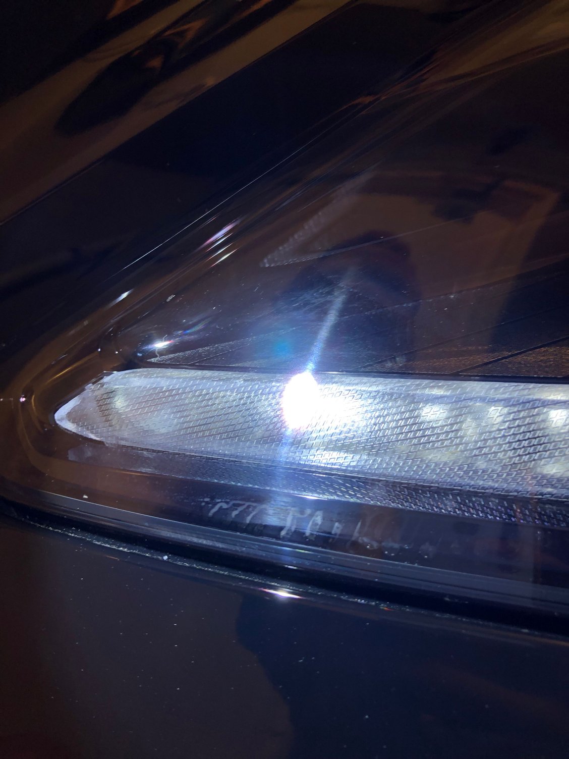

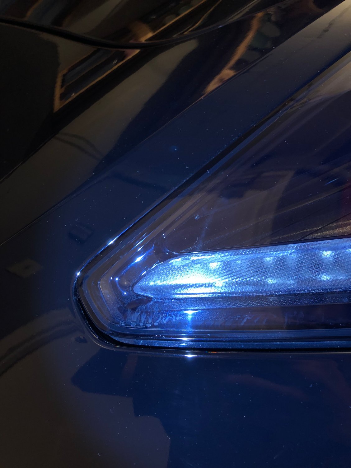

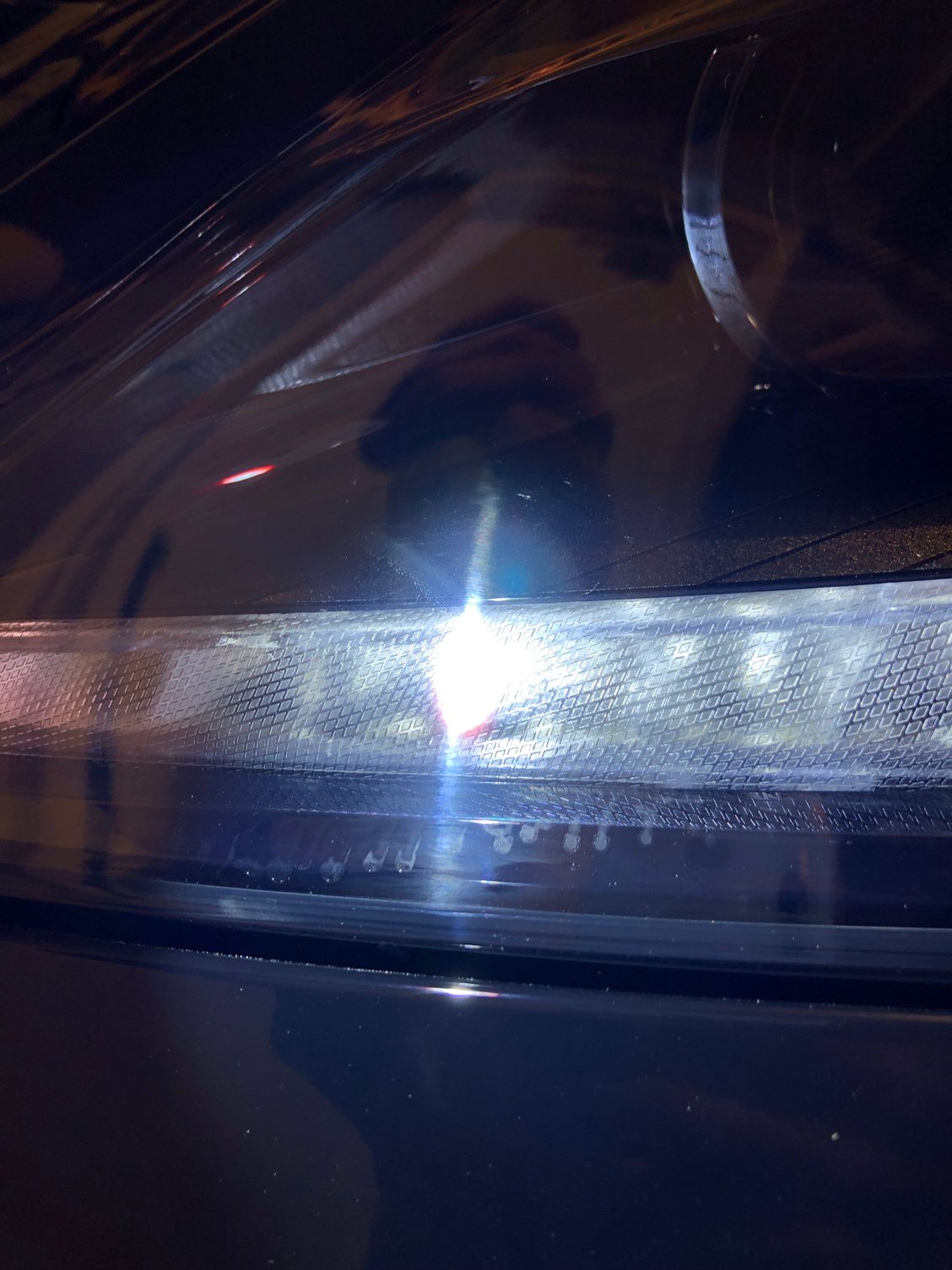

Hello everybody,
I don’t post here much but I wonder the forums daily. Got a question regarding some what seems to be possible streaking on the inside of the headlight enclosure. I recently got some headlight PPF replaced and noticed this afterwards.
I am the first owner of this garage kept, low mileage C7Z and I have never noticed the marks prior. I was thinking it could be some fluid stains between the PPF and headlight interface (I hope), but after further research I realize it could be inside the headlamp enclosure. Any recommendations if the streaking is inside the headlamp and any possible solutions? I’ve tried to sit the car out in the sun for a bit and it didn’t seem to do much.
I’ve read some similar issues and maybe I’m just noticing now. There’s various c8 threads on this issue but not many on the c7 (other c7 threads show actual condensation present).
Might just live with it since I’ve also read replacements can do this over time (fighting what seems like a never ending battle and might just enjoy the car for what it is).
The streaking is only on one headlight (one that had PPF work done recently). Might also remove PPF to verify it is inside the enclosure or not.
thank you

It's definitely on the inside of the headlight. I had the same issue and had my installer pull off the PPF to verify and it is inside the light. This is a reported/recorded issue with the C7 Corvette as well the C8 Corvette. Unless it has changed, there is a good chance the new replacements will leak/streak again, too. I plan on getting mine fixed soon, too. Dealership will have to totally replace the headlights, can't open and fix them, unfortunately.

Thanks for the reply. I have seen some C8 replacement headlights have the same marks and if that's the case for the C7 (it likely is) then I'll save the money and enjoy the car for what it is and worry less.
The marks can only be seen under certain lighting at the proper angle. Not the end of the world but certainly a bit annoying. I still love the car and its fully wrapped with XPEL so I've went to extra lengths to try and preserve the car and make it as perfect as reasonably achievable. I'm pretty meticulous about it.
