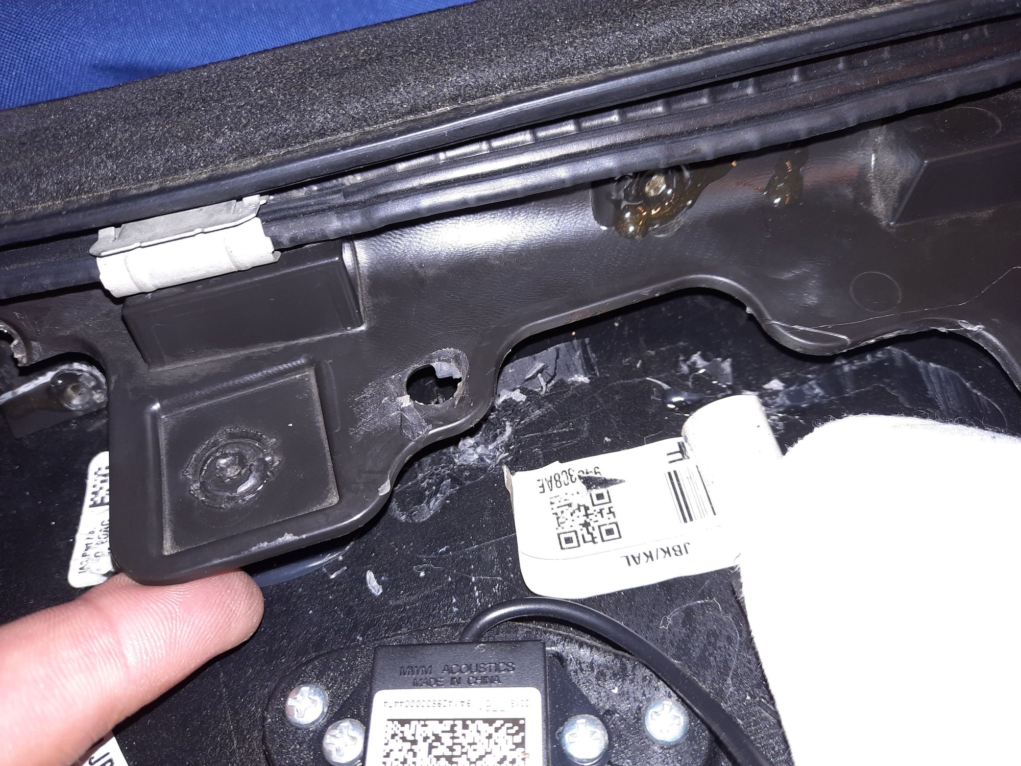

In the picture you are looking at the inside top of the passenger side door panel. While taking it off and reinstalling it twice to deal with a speaker issue I successfully broke a part of it. You can see right where my finger is there is a separation between the top piece and the main panel. I'm looking for advice on how to 'connect' them back together. I tried hot glue and that did not hold. It looks like from the factory these pieces are (for lack of better words) fused / melted together. I waiting for the arrival of JB Weld for Plastic but would be interested in others opinions.

Harbor Freight has a low cost plastic welder.
You are correct, the pieces are "melted" together. The plastic welder would work.
I believe there is a video somewhere on the net that show how they assemble the armrest to the door panel.

It sucks when you run into something like this.
On YouTube, find "Project Farm" videos. This guy tests everything.
Find video: "Which Super Glue Brand is the Best? Let's find out!"
Find video: "Which Epoxy is Best for Plastic? Let's find out!"
For strongest bonding, I found Locktite Super Glue, "UltraGel Control" work be best. But needs 24hours to fully harden.
Plastic to Plastic, other products will work also, like JB-Weld. I had better luck with the UltraGel.

I would use this. From Amazon.
