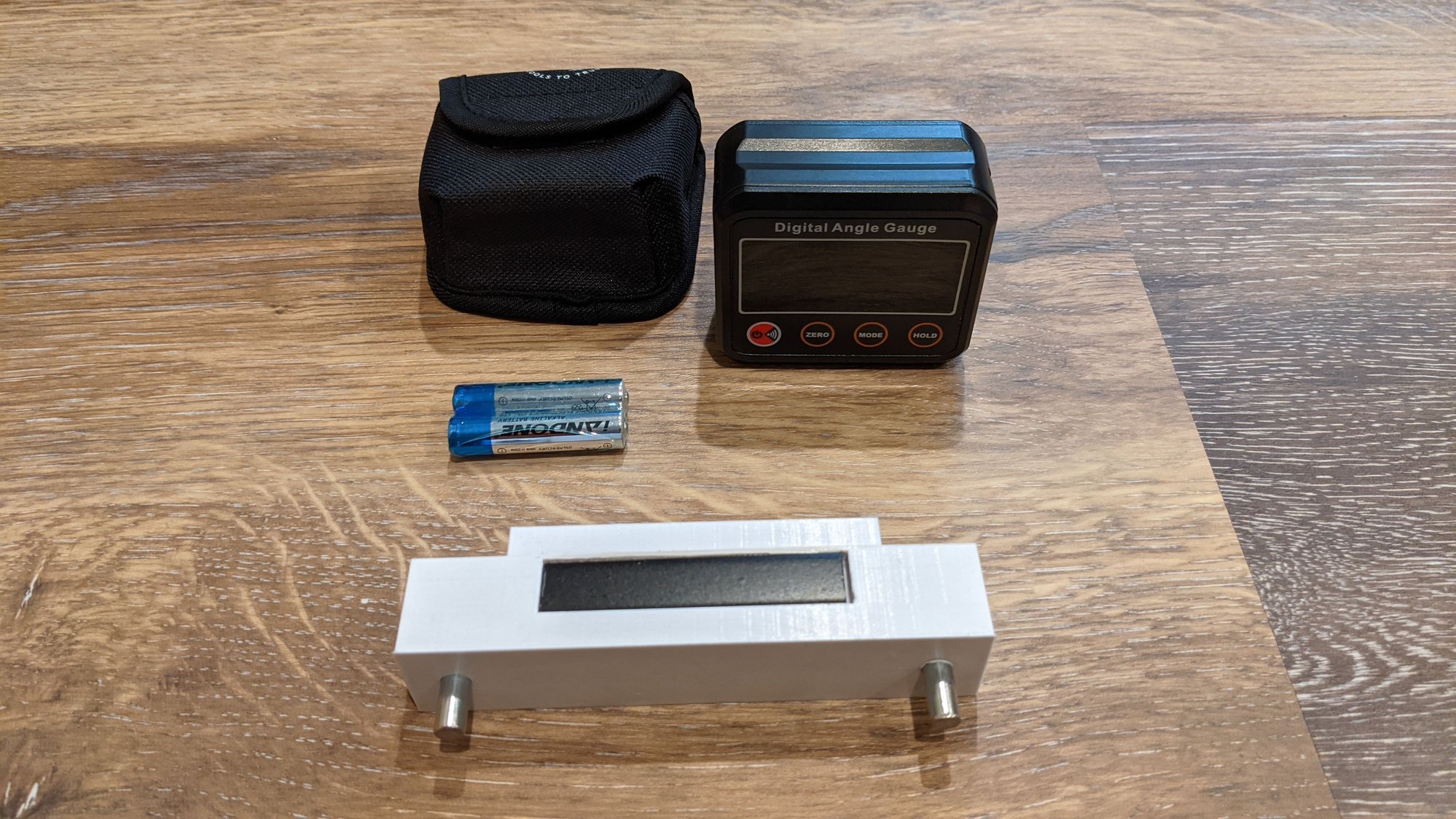

Anyone looking to make precise rear caster adjustments on their C7 pm me.

It looks like you have a great tool set for the C7 Rear Caster issue.

After tweaking out 3 degrees of camber. I had a problem with the rear wheels steering to the right when the suspension was compressed. After having this tool made I found out one wheel was at 1 degree caster and the other was at 4. If you are getting your car aligned you really need this tool to get it right.
This much caster will make you car sick

My caster was in the range when i did my alignment. But my driver rear was forward and my passenger was a tad back. So it made my rear end dance over bumps. Crab walking.
