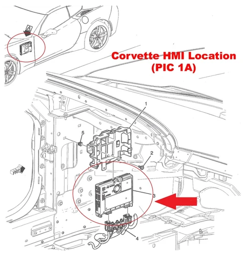

I had problem with the screen on my 2015, 98+k miles, it would go black or just freeze not work at all or the radio would still play with a black screen. I read here on the forum about the module in the drivers kick panel and the wires sometimes come loose. I made sure the wires were secure and havent had the problem since, been over a year since that problem

Check your HMI connections. The wires at the bottom on mine were lose and that was causing random black outs. Once I re-seated the connectors no more problems. Zero cost and two minutes of checking.

This video shows how to get to the HMI unit and its connections...
