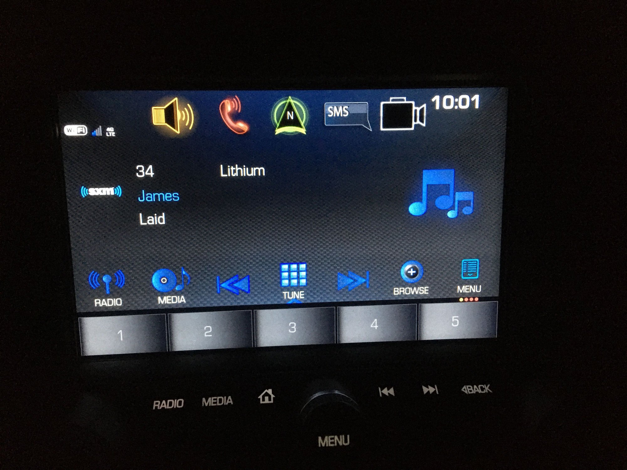

Any advice is appreciated. Coincidently this all started right after I had the car emission tested and a local garage plugged their scanner in to the odb port. Could this be related to that or would it just be coincidence? Would this be a hardware or software issue?
Here is what is going on :
The infotainment screen went blank. I was searching issues with this and there is a way to "Re-boot" the system by pressing the home key and fast forward key simultaneously. And or pressing the on star blue button on the mirror. It brings the infotainment screen back and seems to operate ok. Except sometimes when it's in radio mode the pre-programmed buttons for radio stations are light grey. Then if you turn the car off and on the pre programmed radio buttons come back. See photo.

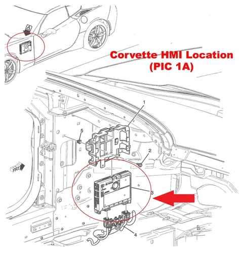

Check the connectors at the HMI location:
I found mine were not firmly seated causing random radio and screen glitches. These connectors are near the OBD-II, dead pedal and hood release lever. Could be unrelated but it takes just a minute or so to ensure the wiring harnesses are snapped in fully.
Will do. That could be it seeing how it was just emission tested for license renewal A connector not fully seated could have gotten jiggled lose when the tech was plugging in and removing the reader.
