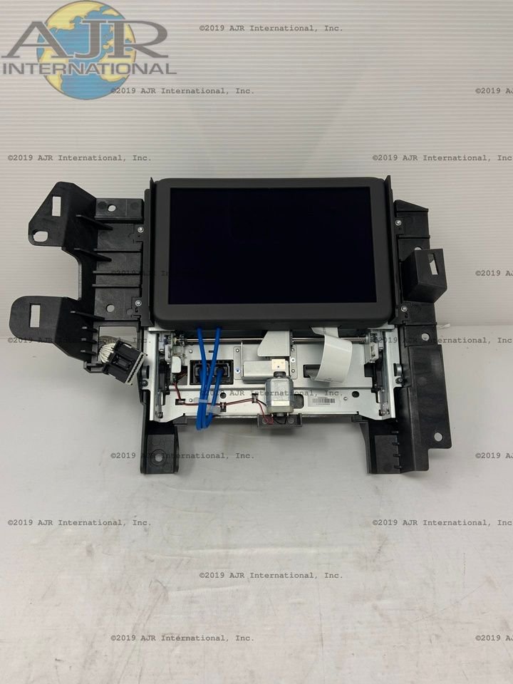

I futzed with my 2014 Corvette "Display Assembly; Driver Information" (aka. "Driver Info Center Module", “Radio Control Assembly”, "F Display") for the past 2 years to stop the jitters, until it finally blacked out all of the time. I spent yesterday afternoon disassembling the center console and instrument panel surround to remove the unit. Not a difficult task (a couple of plastic trim removal tools from Advance Auto, Torx, and hex sockets), but one should repeatedly review these How-To YouTube videos and keep handy to refer to while doing the job:
Word of advice not shown in the videos: move the driver's seat all the way back, move the steering wheel to the lowest position, open the windows and remove the top, start the engine and move shifter all the way to the rear BEFORE disconnecting the battery. It will give you the most working room.
Also, not shown in the videos: you must remove the center passenger side grip trim to access a bolt underneath in order to remove the chromed plastic bead surround trim. It is not otherwise obvious, but the bead trim must be removed as it sits in grooved tabs on the instrument panel surround that will prevent the panel from being removed.
After the display module removal, I could not find any obvious problems, but it is probably a broken circuit board where the USB cables connect up inside. I could not find a way to disassemble unless I drill out the fasteners, so maybe a later job.
Replacement units are getting harder to find and more expensive, as much as $975 just for the unit quoted to me by a dealer plus additional labor costs to R&R.
Here is a source for a replacement display module with a reasonable price:AJR Intl Electronics Repair (https://www.ajrinternational.com/). AJR is one of only five GM Electronic Service Centers authorized to provide GM Radio and Cluster Exchanges both in and out of warranty. Although AJR services auto dealers, if you call Chico at 800-232-3965, they will sell you a unit outright, no exchange. I paid $590 +$20 overnight shipping, and it arrived in less than 24 hours even though I live out in the boonies. Or you can send your unit to their Repair Dept., 300 Regency Dr., Glendale Heights, IL 60139 for repair (they quoted me $500).
Note that your original unit's GM Part # may be 23434219. However, it has been superseded over the years by backwards compatible # 84182649, 84577759, 84664816, and 86542368. AJR sent me a brand new GM 86542368 unit, not a rebuilt. If you search around and ask for any of the earlier units, you may get a response that it is Backordered, No Longer Available, Out of Stock, etc.
Good luck!
Instrument Panel and Trim Removed
Instrument Panel and Trim Pieces
Display Module Original GM PN 23434219
New GM PN 86542368
