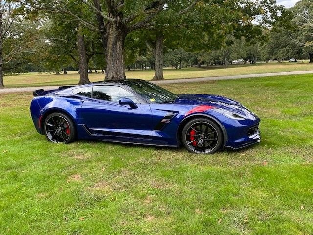

Agreed, it's a beautiful area. I'm h
Admiral Blue - 2lt
ere in little Rhode Island. My car is put away for the season as the roads get messy due to the weather.

Beautiful car. We've been thankful for a warm winter this year. Haven't had to put mine up or worry about swapping wheels lol.
