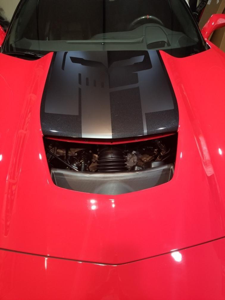

today was the day...took my time with my friend...keeping everything as wet as possible...never can't use enough water solution...started in the center...lined everything up...squeegee started in the center...worked from inside to outside...front to the rear...and waaala...Thanks to all...really appreciate it!!...bigtime

Looks like a pro job. Cool.
