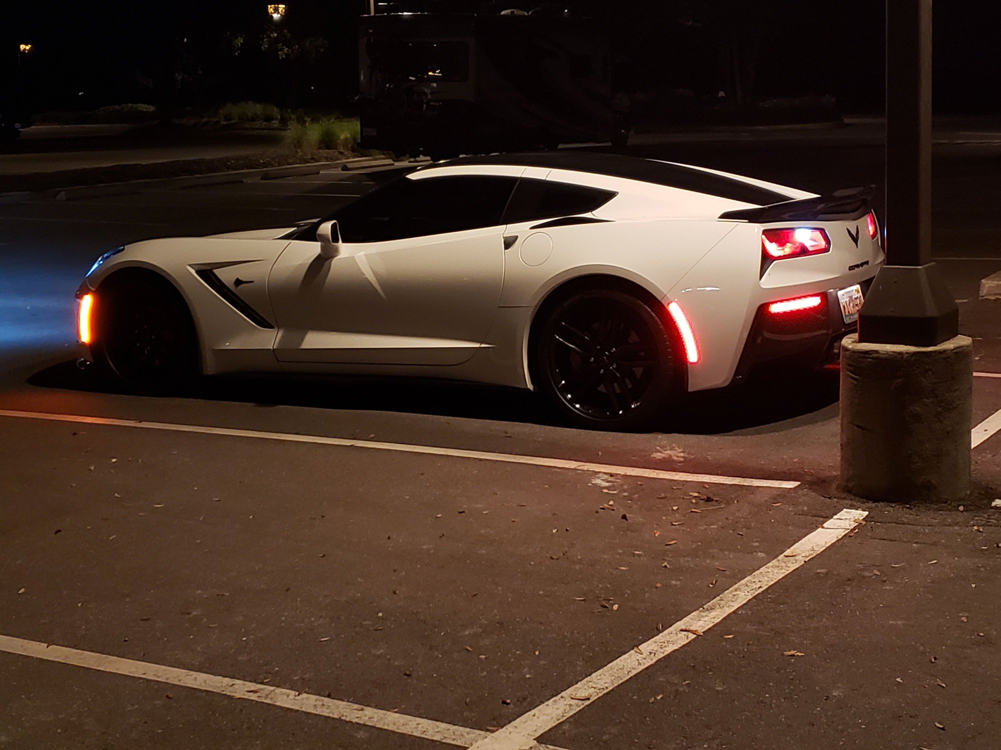

I tapped into the rear side markers. No TPMS errors.

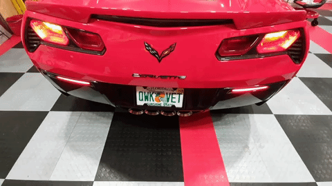

No issues with TPMS here. I understand there is another option that has yellow and red sequential available, but as you see, I did not try that one.
