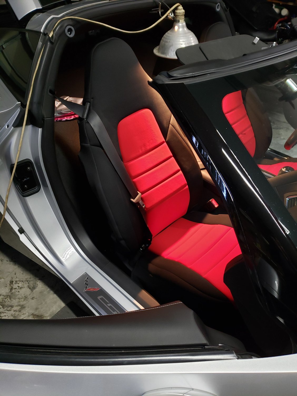

Looks like you have an explanation for the arc and I will say the new seat covers look very good. How was the install?
Thanks Vetteman,
The install went pretty good. Most difficult part was figuring out how to remove/disconnect all the small things like the covers for the nuts at the front of the seats and the covers for the seat belt attachment. I watched several Youtube videos, but none gave the specific details of how to do this. Basically just "pry apart here" or "release this clip"
Once I figured out those things, the next most difficult task was lifting the seats out of the car by myself. While not extraordinarily heavy, they are not light, and a bit cumbersome.
I can't see any way possible to do these while in the vehicle; at least not by yourself. I'll probably pull them again at some point to install some sound deadening material.
