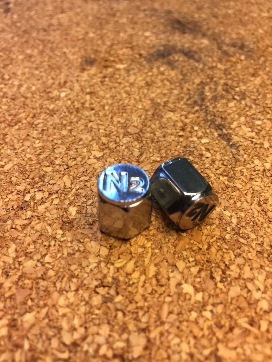

I just purchased a C7 GS and just learned it has nitrogen in the tires. What is the procedure for purging the nitrogen to add oxygen. I assume I must replace the valve stems as a conventional gauge will not fit. Would appreciate any suggestions

I don't think any need to do anything. Eventually as you add air the tire will return to the natural atmosphere mix of N and O2. I thought the only change on the valve stem was a green cap. Is it really a different valve?

I don't think the stems are any different. I think some places just put a green cap to let you know it's nitrogen. As far as I remember, you can mix air in with no worries. Costco used to do all nitrogen and free if you're a member. Not sure who else uses it.

No need to do anything, just add AIR as needed. My '17 GS came with nitrogen. Only difference was the valve caps identified the nitrogen.

N2 does not change as much as "regular" air with temperatures. That is why it was started. Your tires will wear out b4 the inside gets old. Just fill as needed - no other valve needed.
