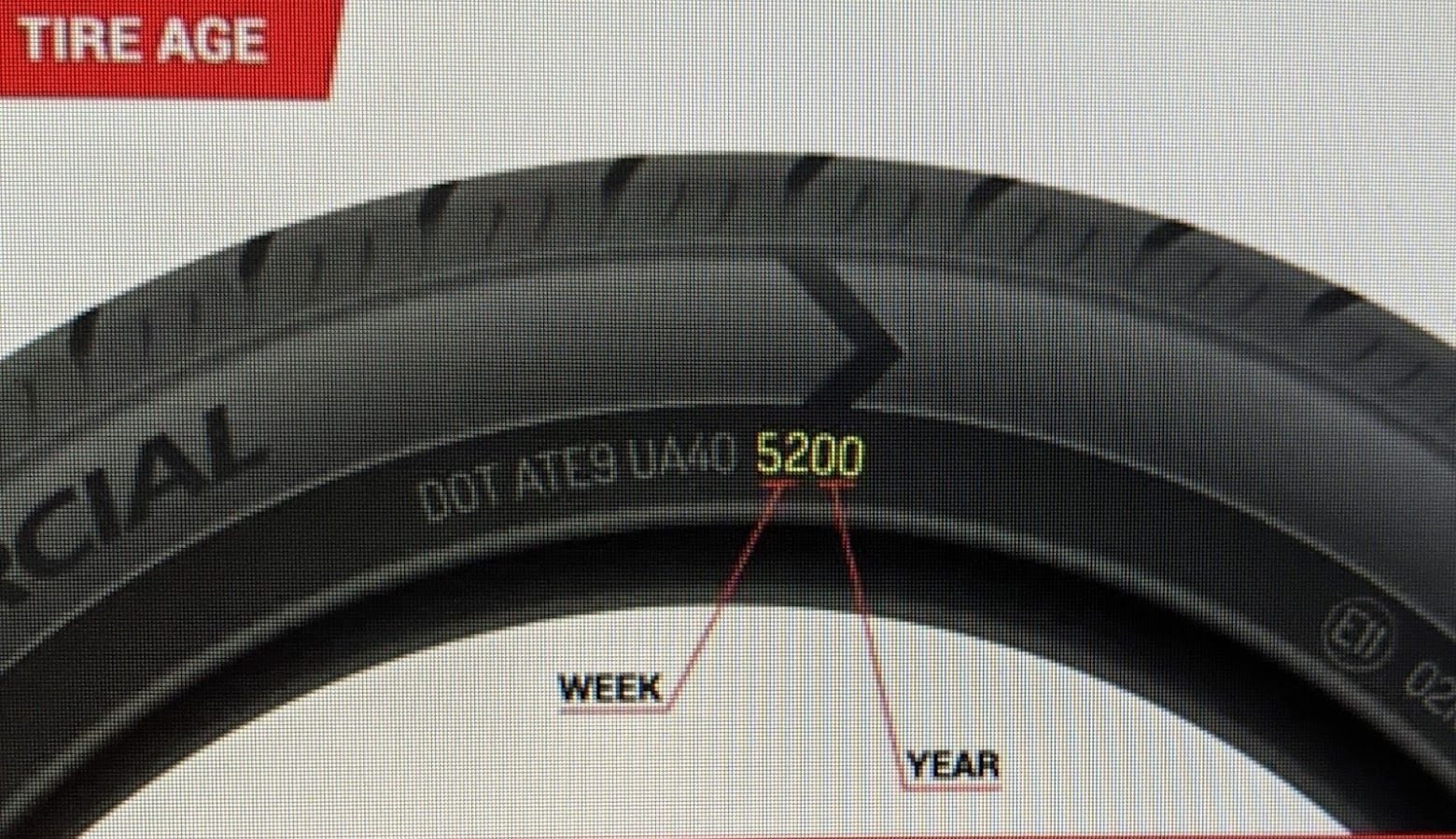

Check the date code of the tires.
To Know issues?
