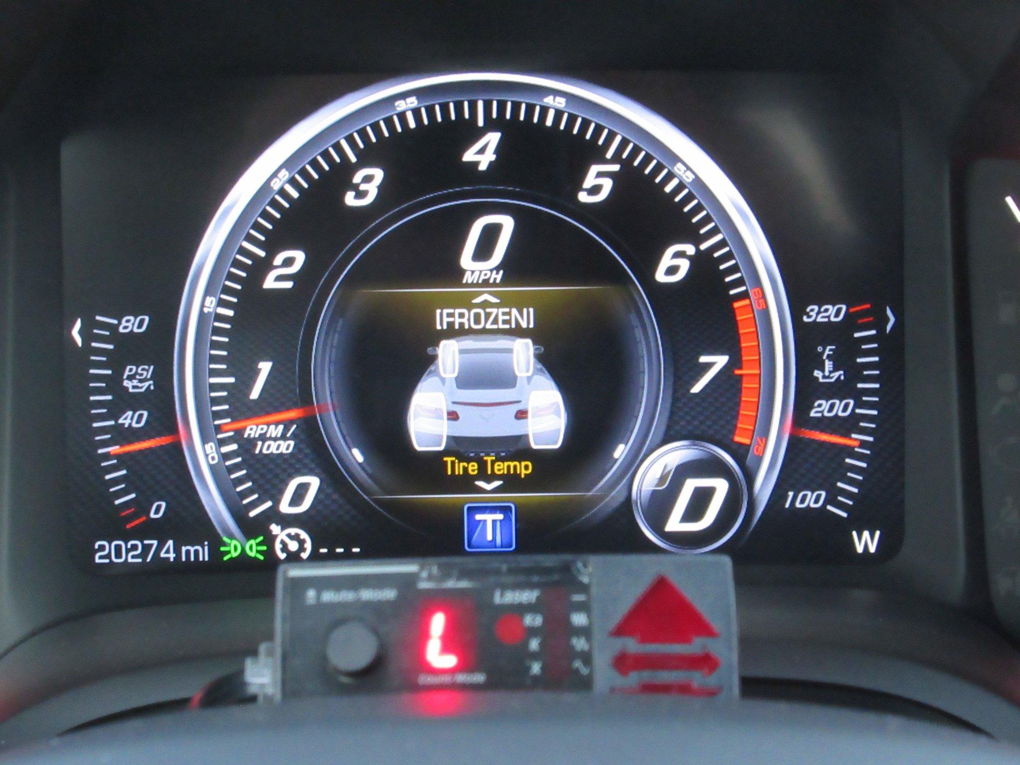

Hoping OP has A/S tires on his car.
GM warns that original PSS can crack if driven below 20'F. Not always, but sometimes.
And of course, grip is pretty crummy on dry roads and almost hopeless in snow.
Our 2017 Z51 warms up coolant and oil to 170'F or higher in any temp.
The pic was taken at -12'F, though we were driving slowly so not a lot of blast through the radiator. On A/S Michelins.
