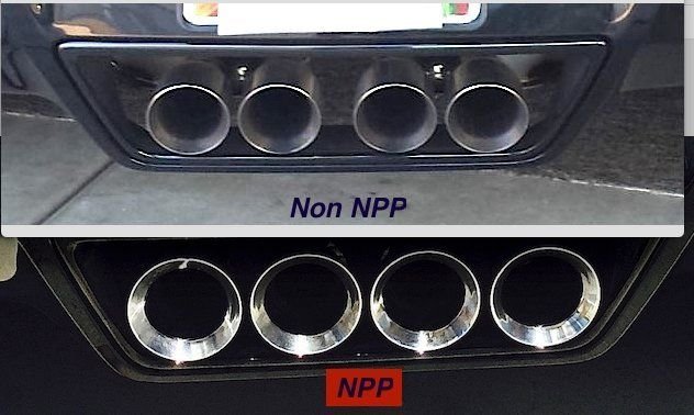

For anyone who wants to know how to determine if your C7 has NPP:

Originally Posted by Maxpowers
Be sure your car was equipped with NPP from the factory otherwise the valves will be open all the time.
Thanks for the heads up. But help me down from my pinnacle of ignorance. How can I tell if it originally had NPP? It's a 2014 Z51. They came with differing exhausts? I can see why they would stay open if not NPP originally. The ECU wouldn't be programmed to control it. It did throw a check engine code which the Chevrolet dealer mechanic told me was due to not having the stock exhaust. Apparently, it had never been run in eco mode before. This, in spite of the performance recorder showing the average speed for the past 3500 miles to be . . . 32 MPH. And that is after I drove it from Ohio to Oklahoma on the interstate. Driving that car for 3000 miles at 25 mph would . . . well it just would.
Old Feb 6, 2022 | 11:12 AM
Maxpowers's Avatar
Maxpowers
Joined: Aug 2015
Posts: 6,884
Likes: 2,887
From: Toronto
The RPO (option) code for NPP is conveniently NPP. In my 2016 the option codes are listed on a sticker in the trunk under the carpet by the battery.
