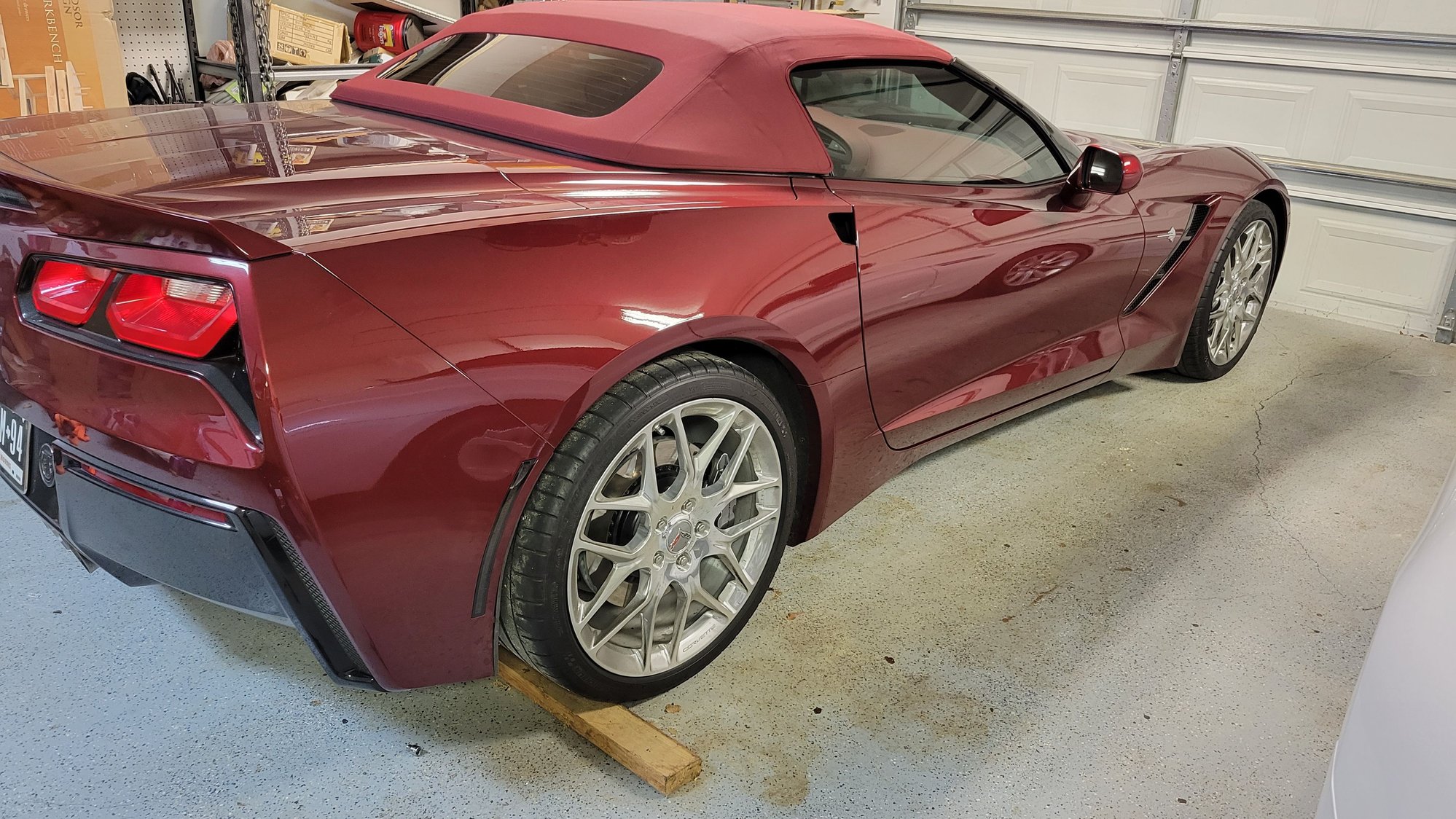

Originally Posted by jaywoo
Oracle lights.
Your car looks sick. Love the red interior on that color..
