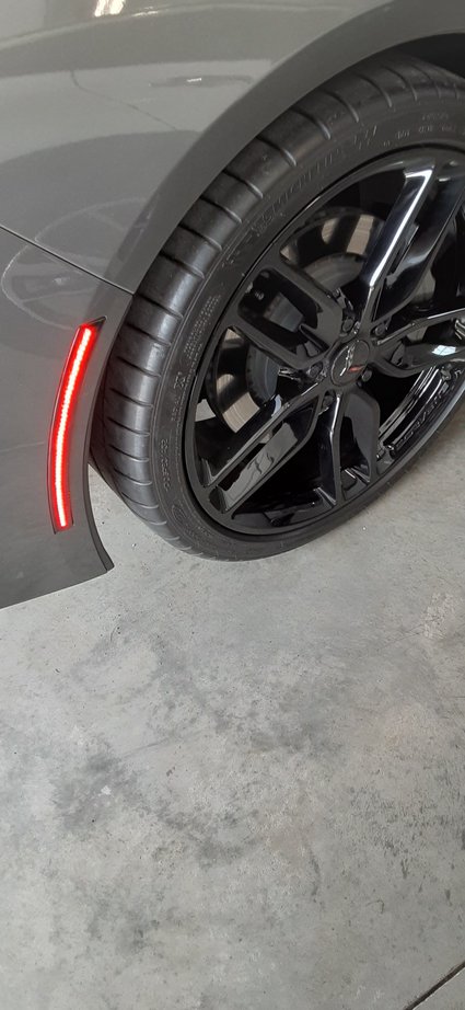

Just installed Oracles. Haven't even pulled out of the garage since but they look amazing! Yes, they are not flush but I don't even notice it. They just look too damn good. I didn't get the painted ones. I got the tinted amd ceramic coated them.
