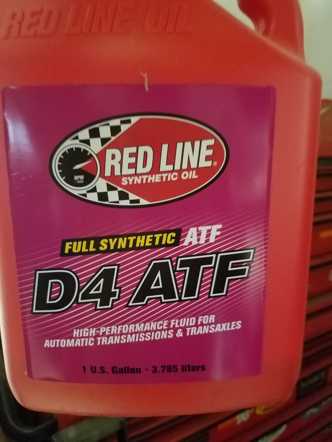

I have to say that when I got my 19 w/ 4000 miles on it I was surprised how stiff the trans was. I did the skip shift mod after I got the crap scared out of me by a big truck filling my mirror because I couldn't accelerate in 4th. Then I did the oil change.
I also did the tsb procedure for shifter adjustment. In the last couple of weeks I have had the opportunity to drive the car in 30deg weather. The things I have mentioned doing, and the 15000 miles I have put on it, have made it into a nice trans. Not quite as smooth and easy as the 6 speed in my wife's 15 Mustang GT but close enough.

Nothing wrong with putting premium tranny fluid in, but the consensus here is that it doesn’t not fix the grind on the 1-2 up shift when cold.
