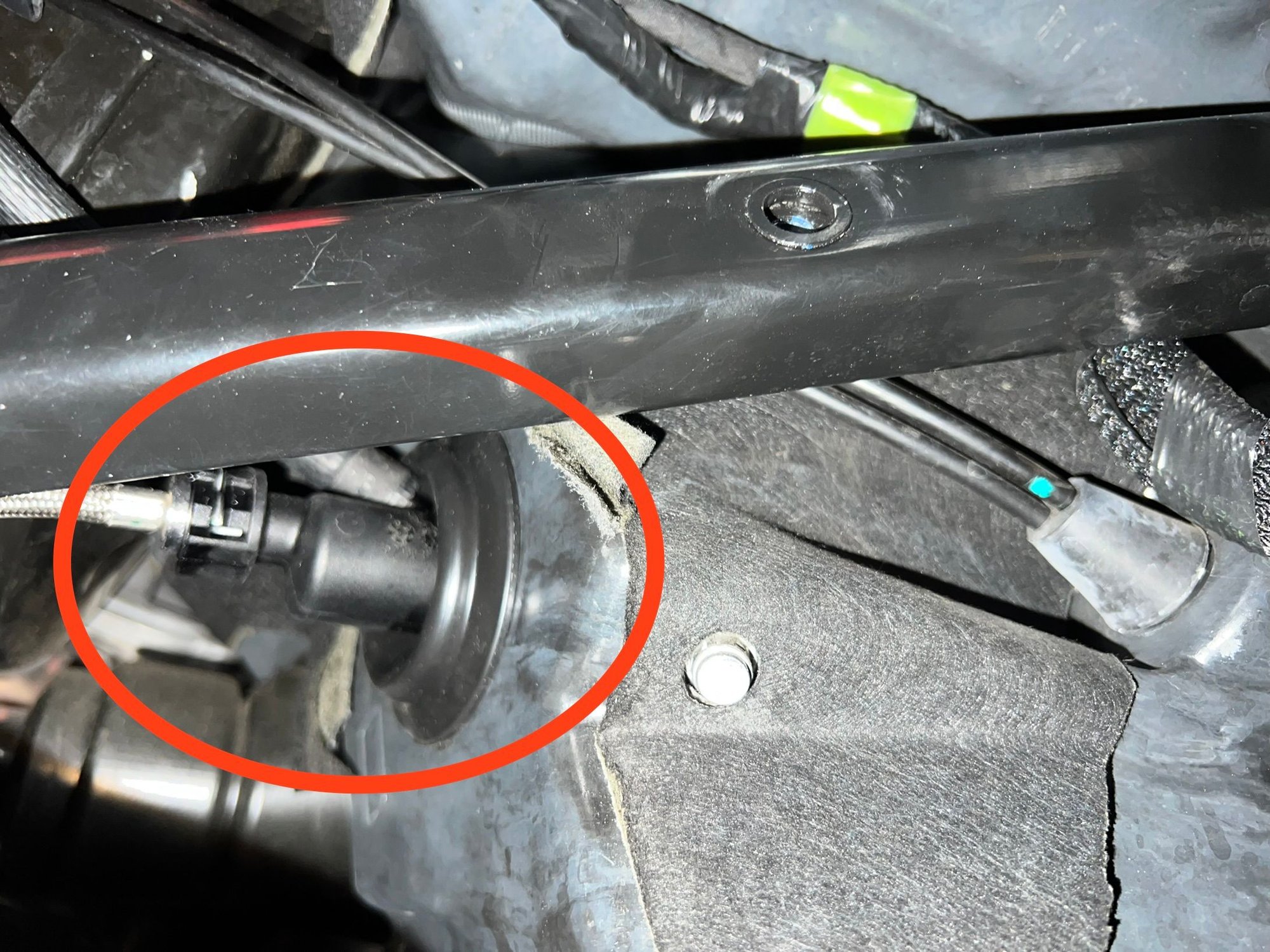

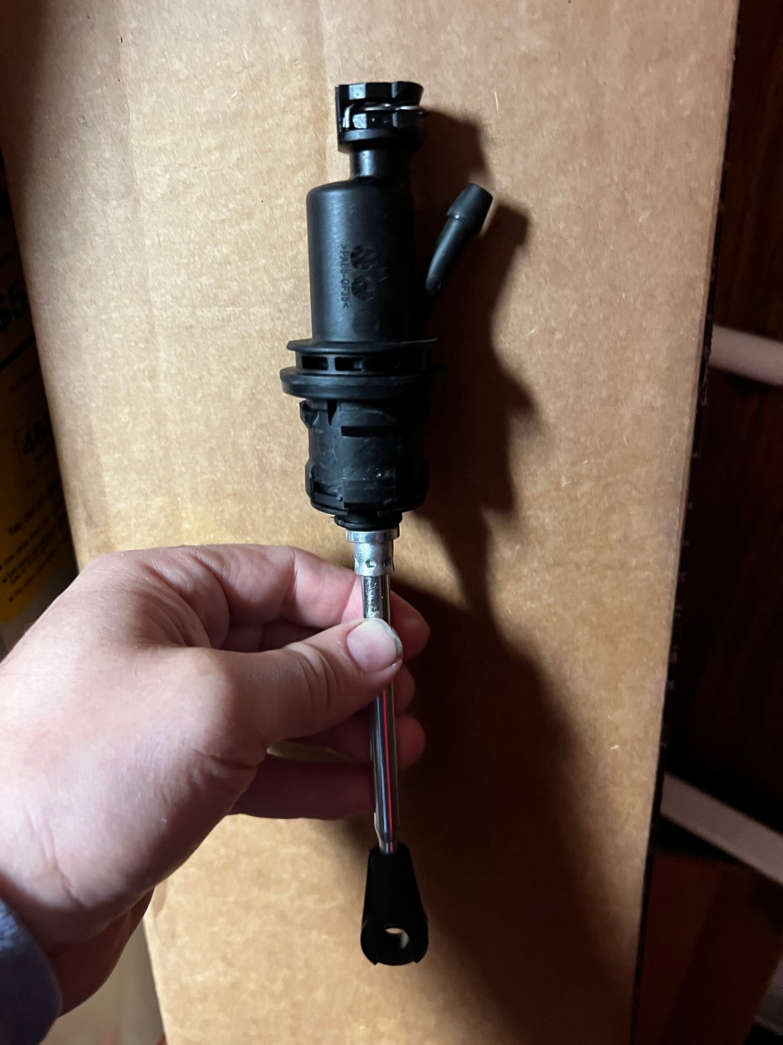

Stupid issue and maybe I will ask for some guidance. I got it tore apart and the master cylinder had rotated out. I got it spun in but and the clutch is working. It says now to engage clutch to start. Is there a fuse or something that probably went bad? I don’t see a sensor on the master cylinder that could have been damaged.
Also, I don’t believe I got it all the way out snapped in. Yep I was trying to rotate it from the inside without marginal success. Any recommendations?
I haven't done this level of maintenance on my C7 but, for other vehicles on which I've worked, sensors/switches like this were located inside the passenger cabin, under the dash, as part of the clutch pedal (rather than master cylinder) assembly.
I disconnected the battery negative for 10 my na and issue went away. Was able to start the car.
Nice job, I’m impressed you could get it rotated much at all from the inside. I replaced the master a while back and it was a huge pain rotating it completely from the outside. At least when on jack stands. Maybe easier to get to on a lift at just the right height.
Some reference pictures.
