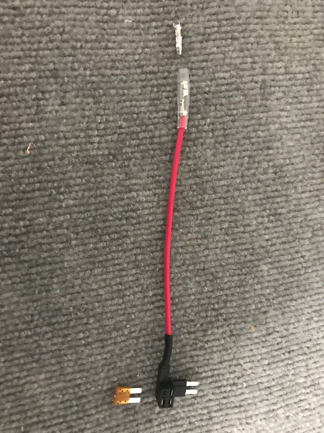

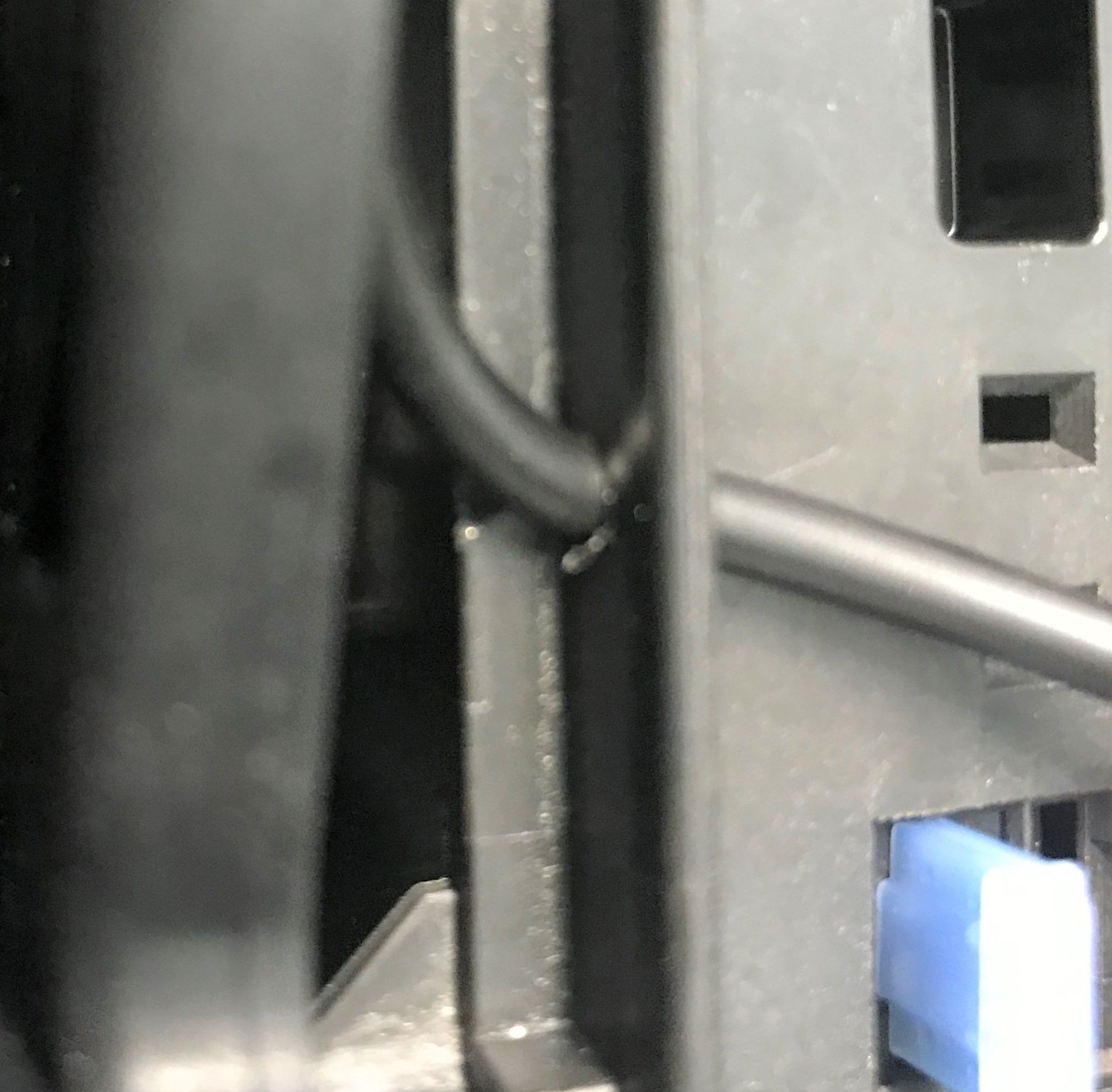

I do not know where you can find power source that is switched by the ignition other than in the fuse box, when I wired in an after market front parking camera I used an "ADD A FUSE KIT" at fuse 31 on my 2019 1LT works fine.
Here are a few photos that may help.
ADD A FUSE KIT
Fuse kit installed
Cable to camera penetrating fuse box

You can still do the same as I did, there are other fuses in there with power on them all the time.
I guess you will be turning the lights on with a microswitch or magnetic sensor so they come on when the hood is open or something similar?
