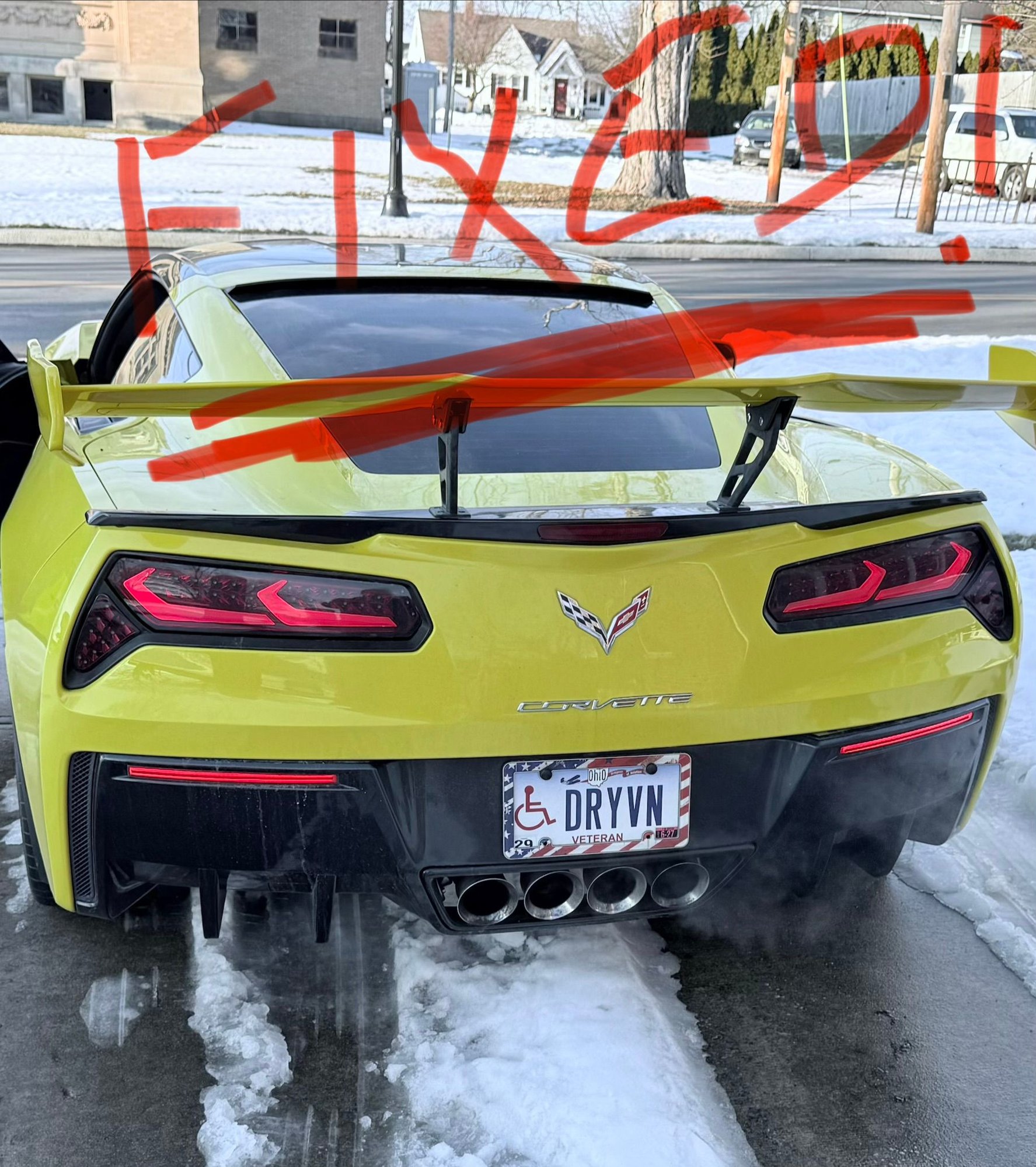

Old Feb 11, 2026 | 05:22 PM
Sakrificer's Avatar
Sakrificer
1st Gear
Joined: Feb 2026
Posts: 1
Default Use a OBD2 Scanner / clear the codes.
Originally Posted by Crcvette
I am stumped! Took my 2017 stingray out for a ride the other night and was flagged down by multiple drivers that my left tail light is not working. After further investigation they were right and my left tail light does not work however brake light directional and reverse all work on that side. Hazards and running lights do not work on that side. I have taken the Light and plugged it into the other side and it works fine so I know the bulbs are fine. I took the right side and plugged it into the left side and nothing. Any ideas out there?
To One taillight not working
