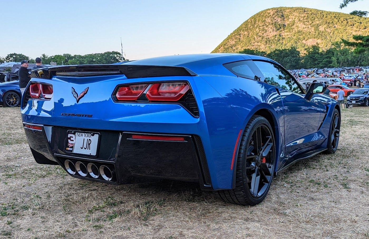

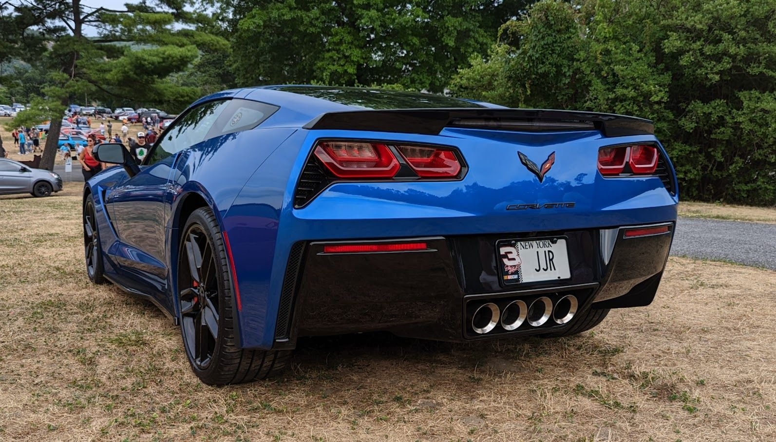

Paint Correction will remove most of the Clear Coat so be Careful who you use. My 2016 C7 will be 7 years oil Sept 27 and still looks like new with NO Ceramic Coating. I work at a Auto Body Shop and they Don't Recommend Ceramic Coating and they said it is a Cash Grab !!

I respectfully disagree with a number of your claims. When done properly, paint correction will NOT remove most of the Clear Coat. Your 2016 C7 DOES look great, but I'd argue that's because of the way you care for it, rather than because it has no ceramic coating. Auto Body Shops know paint and body REPAIR. They may or may not be familiar with DETAILING processes and products like ceramic coatings. I'm sure there are some detailing shops engaged in "cash grabs," but reputable ones perform TIME/LABOR INTENSIVE SERVICES. Assuming you choose the one(s) with which you do business carefully, you'll GET THAT FOR WHICH YOU PAY.

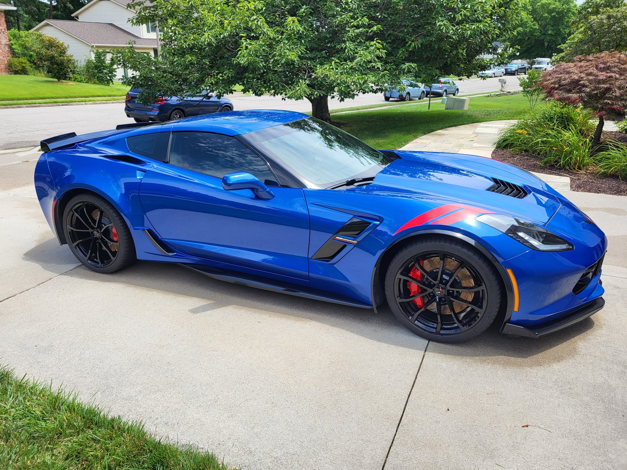

I have used the Adams Graphene, GTechniq CSL/EXO combo and CQuartz on numerous vehicles. All are very user friendly and have given great results.
Just to see what would happen, I applied the Adams coating on a door on my work vehicle and for over a year didn't wash the vehicle. went through multiple climates, temps, mud, dirt, rain and after the year washed the vehicle and that spot was like I just applied it.
I will always recommend coatings to people. if you are game to tackle it yourself, follow the guidelines of the manufacture, take your time and you'll be good.
the initial prep and maintenance will determine how long it'll last

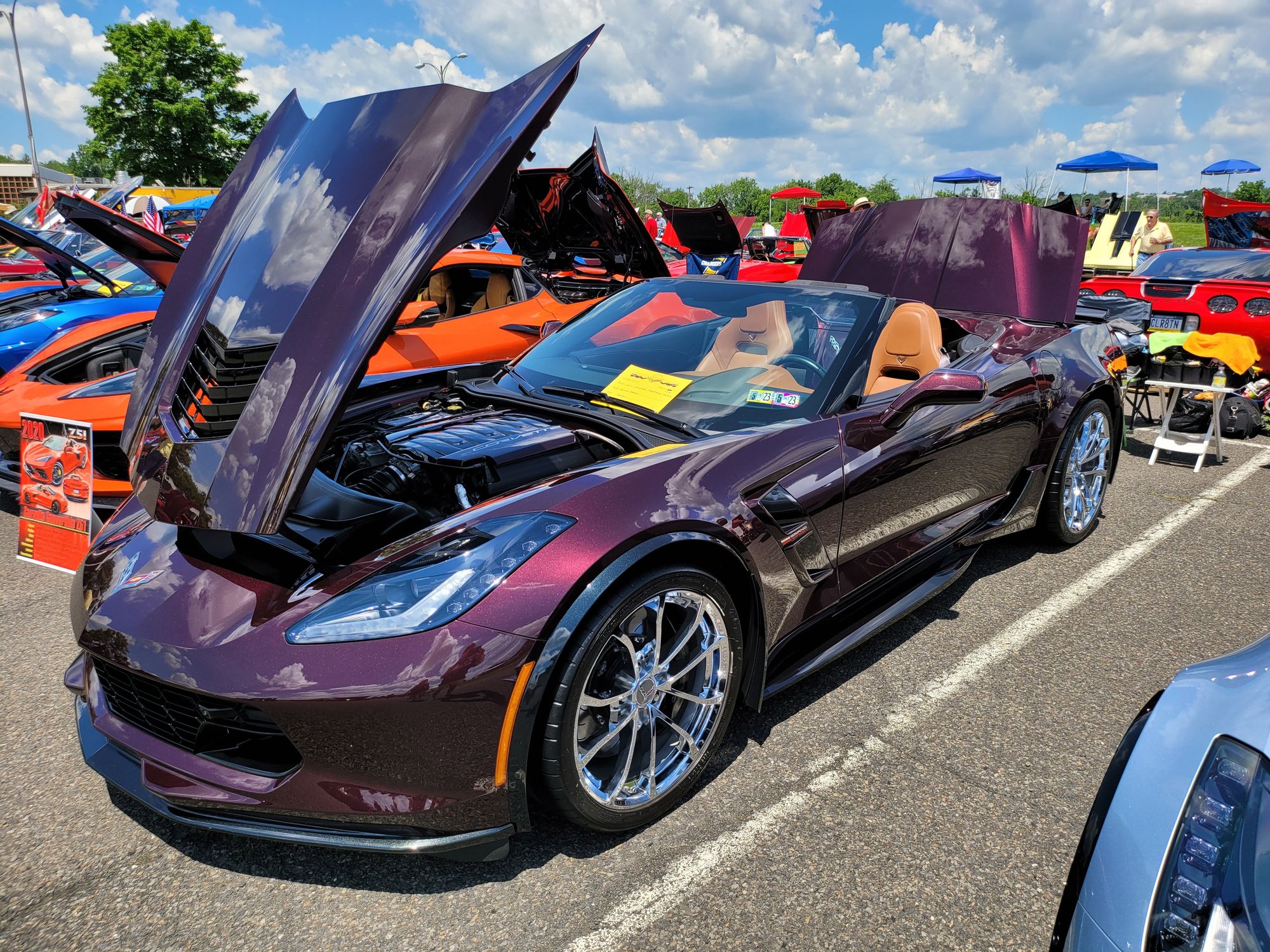

Lets make this simple. If you are a DIY - there is no other product you need to buy than this kit from Adam's. It comes with everything you need to completely ceramic coat (2) cars. The nice thing about Adam's is that their ceramic shows up under a UV light (which they include) so you can see spots that you might have missed. This makes it worth every penny because I definitely found spots that I had missed. Regardless of what ceramic coating you use, you ABSOLUTELY must go through a full paint correction. That means you use a strip wash (to get rid of all previous wax and sprays), then clay it, then compound it, then polish it, then an IPA wipe then you ceramic it. My Vette took (10) hours all in (6 hours in paint correction + 4 hours for applying the ceramic). Below are the results... I was surprised how easy the process was and cant believe people paid $800 to $1000 for getting this done...but the labor is in the correction.
