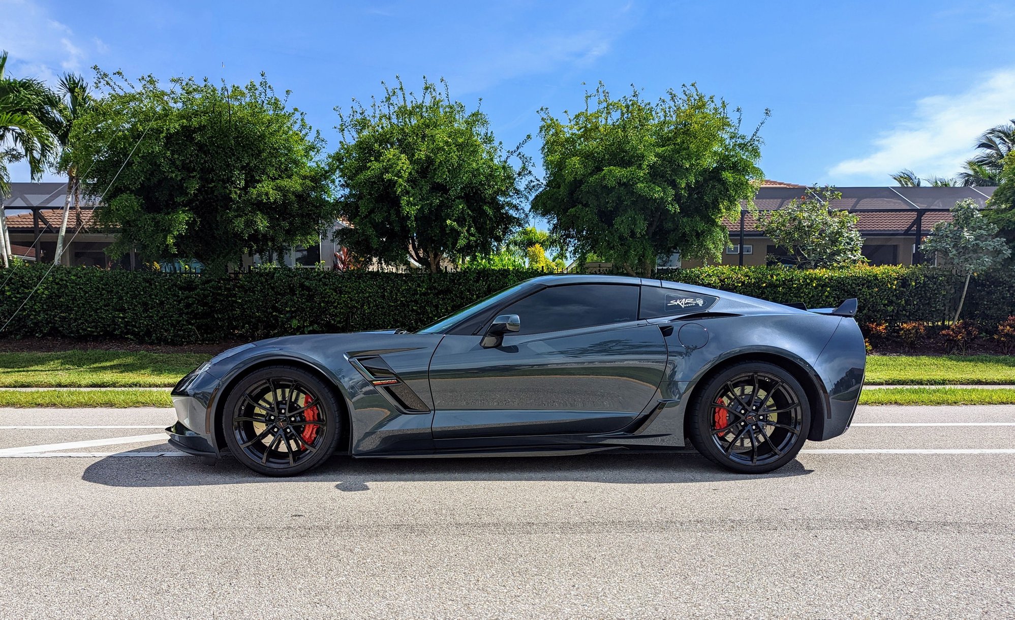

This is after lowering mine cut the front lowering bolt rubber pad in half and lowered front bolt all the way 26 5/8. Rear went really low on stock bolts I actually raised it back up and didn't t cut them sits about 28 inches give or take gas in the tank lowers or raises a little bit due to weight. I had it aligned but from the factory my alignment was OK, by that I mean even tire wear. The alignment shop said my alignment was out of whack but that's because I lowered it. I never checked the stock alignment. I have seen vetts lower than mine and they didn't cut the stock bolt. Every car is a little different from stingray to Z51, GS, Z06 and z07.
